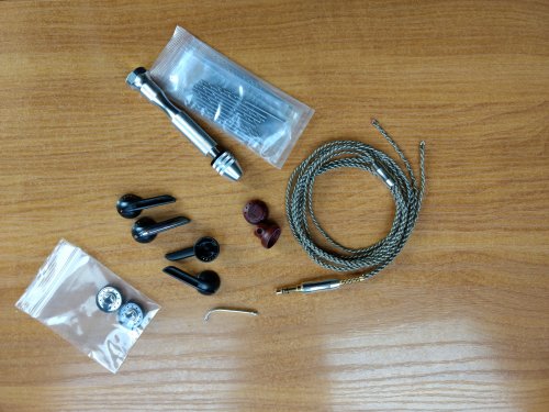

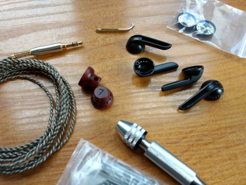

I've received a couple of stuff recently I got a new cable, new shells, drill kit and another set of 19-21 speakers. I really like this cable, for the price (3.8usd) it looks and feels great in my opinion, soft and doesn't tangle, plan to build something with it soon. I'm also thinking about mx500 drilling mods, not sure what to try but will experiment soon.
The shells on the other hand are quite a disappointment so far. Neither of them can snap on speakers without glue, they are extremely loose, can't even hold mx500 cover in place, especially the wooden one where the two units has somewhat different diameter as well. These will need a lot of glue to hold anything. (even steel mesh or dp100 cover) Did you have a similar experience? I thought that I can at least try these out beforehand but there is zero friction or snapping with most covers. The plastic shells are very loose as well which is unexpected. The plastic is cheap, but hopefully they will sound decent after glue. I have an e8000 glue on the way, hopefully it will arrive in one piece lol.
Basically I can't do anything worthwhile without it, even the remaining mx500 shells (plus the Qian69 and others) are a bit loose so I can't really create channel balance or repeatable results at the moment.
links
cable https://www.aliexpress.com/item/32969752353.html
drill https://www.aliexpress.com/item/32665380010.html
wooden shell https://www.aliexpress.com/item/4000477388117.html
plastic shell https://www.aliexpress.com/item/4000851137552.html
links

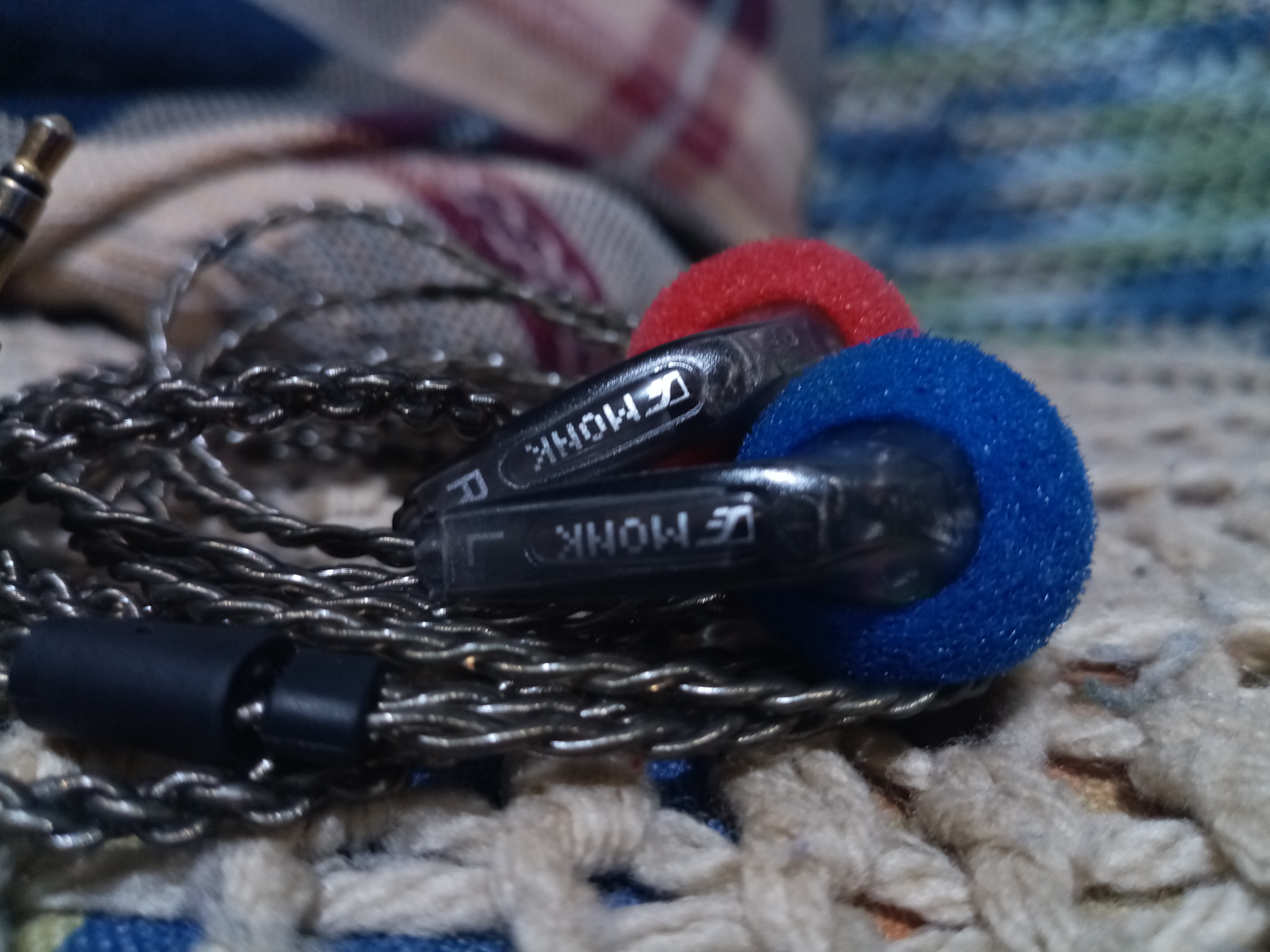

Recabled my VE Monks Plus!
I used my stock IEM cable lying around.
Thank god the shell wasn't glued shut, so I only applied a bit of acetone on needle at the seams.

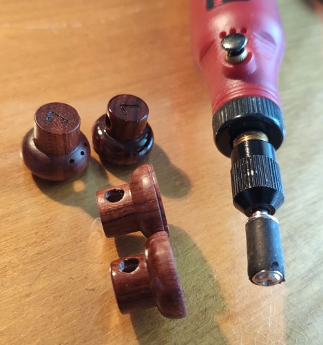

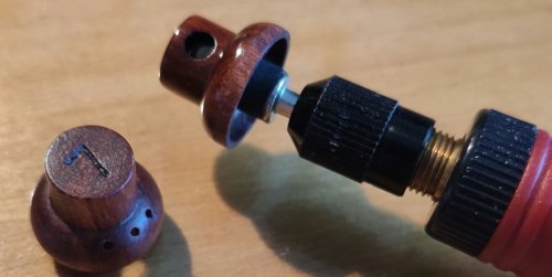

There's a way for the wooden shells to get bigger and snap in the drivers.
I don't know how it will sound because I didn't solder the drivers yet.
I also wanted to make a dip in the shell, so it doesn't break/rip the drivers coil when attaching.
This what I tried with the wooden varnished ones:
I sanded down the groove/edge (you can sand it all or leave some), so the shells got smaller in the ear.
Because there is no more groove/edge, the shell diameter is now larger.
I then needed to sand and adjust the new diameter so it would snap in the drivers.
Note:
To uniform and easily sand/adjust the new diameter, I fixated the inside center of the wooden shell in a very small low power USB battery drill.
This way the shell rotates and I just carefully touch a sand paper with it.
