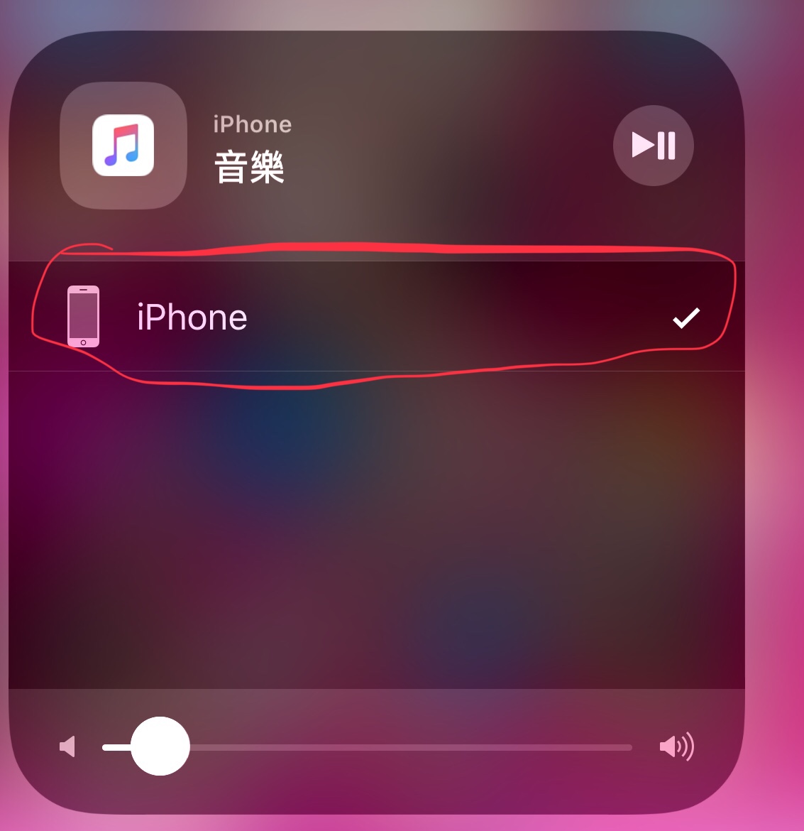

I got the similar case before, which was caused by the airplay is still catching the connection in my mobile, so the DLNA will just play for one song or few seconds.
For my case, I can resolve it by double check is the airplay still set Poly as the player, if yes, then change it back to iPhone, restart the app for DLNA connection. It worked fine for me, but not sure is your case as same as mine.
where do you check whether airplay is still selected? you can't select iPhone in Roon. I have made sure all my player apps are selected to iPhone and then I have shut them down. Grateful if you can provide more info. Thanks for your help!

Dec 1, 2017 at 9:05 PM Post #4,188 of 18,774

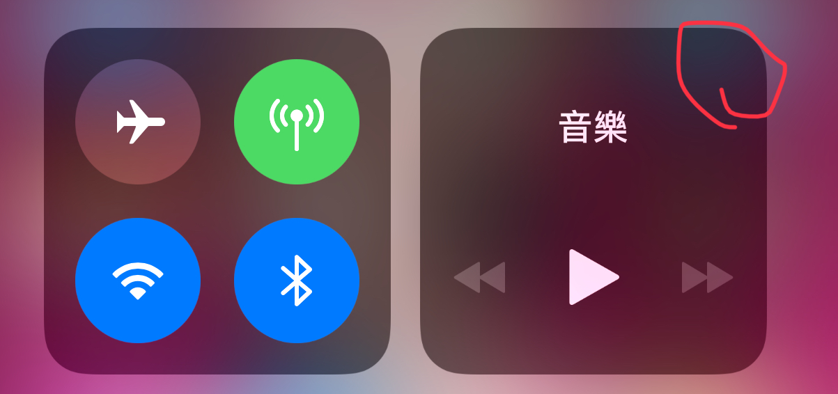

I’m not using Roon, so may be different case. But here I can show you how I check the music output.
Slide bottom manual out
As the above to make sure it is using iPhone to output music not poly. Then restart poly and the app, and won’t have problem any more for my case.
For your case, may also be connected by other devise so kick you out of the connection, just guess only. Hope this can help.
