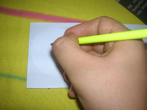

For this mod  you need some adhesive felt, small scissors, a small screwdriver, a pencil and some paper.
First thing is to draw on the paper 2 circles, the outer with a diameter of about 6.4 mm and the inner with a diameter of 2.5 mm, then cut them from the paper with the scissors
After this you have to copy the cutted circles on the back of the adhesive felt, using the previews draw to help yourself:
Once you've done, cut the felt with the scissors:
This is the final result:
