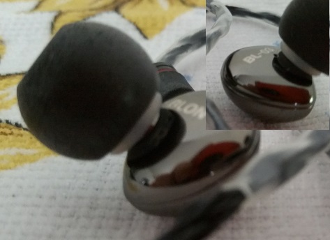

For the Blon BL-03Is the spacer mod a gasket in the nozzle?
I used silicone O-Rings, 4mm Inner Diameter, 8mm OD, 2mm Width (AKA Seal Gaskets). Topped with Comply Comfort Plus Tsx-500 Memory Foam Earphone Tips. An added bonus to the Comply's is the built in wax/debris guard, which will allow you to experiment with the modifications.
For more info on the Blon BL-03, checkout the dedicated thread: link
