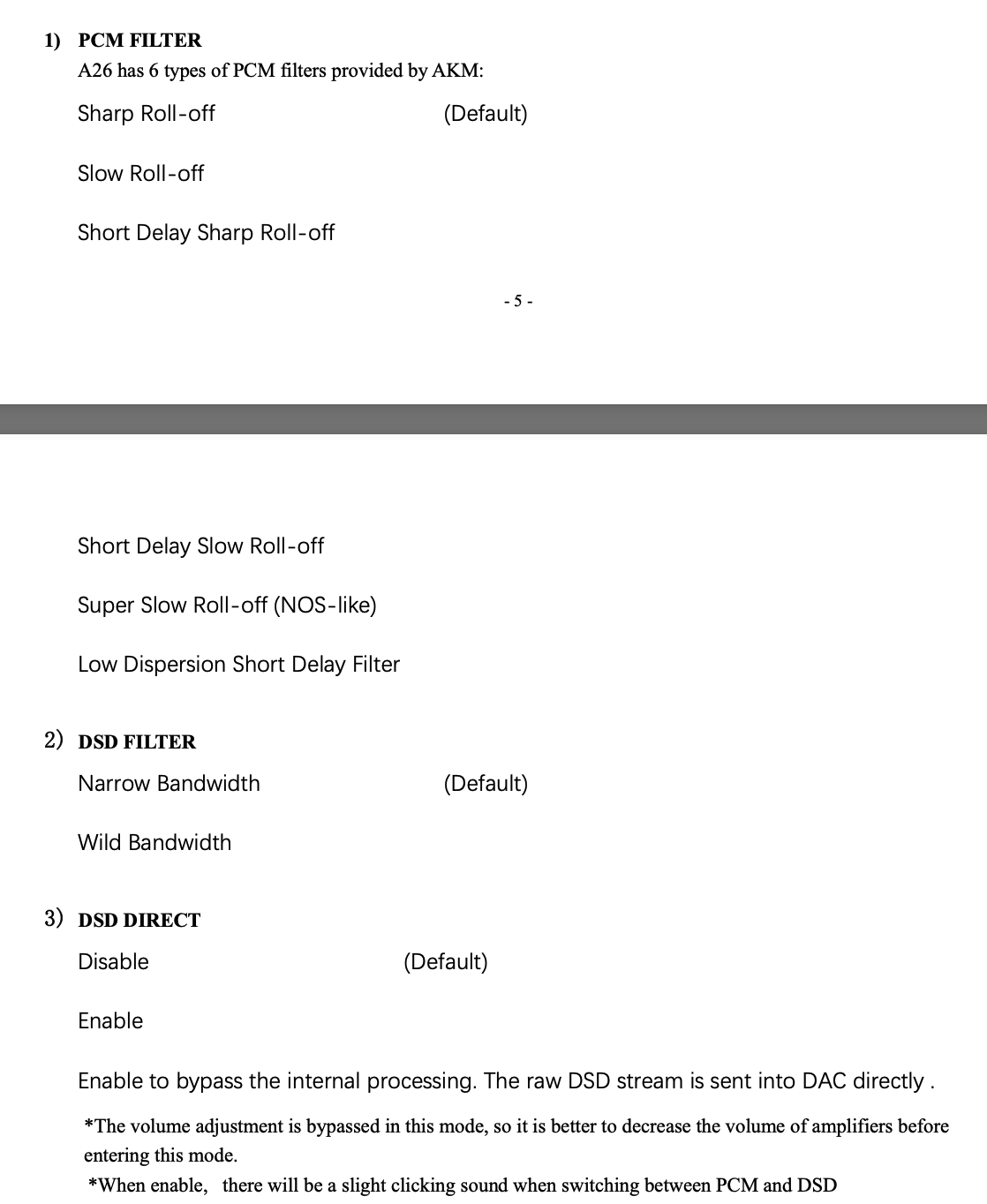

The designer doesn't activate it on the chip. It is activated in the firmware. Have you heard on other forums if other manufacturers using AKK chips process DSD directly and enable it for that purpose? Is it the same as Gustard has done here? I am interested in how many amps a Linear Power Supply should have for an AH90. What do think might be best for a 12V....2ampers is the minimum or the AH90 will not function. Any suggestions?
Apr 18, 2024 at 6:07 PM Post #332 of 374
Yes that’s what the firmware does. It enables the ability that’s built on the chip to bypass the all other DSP functions.
Only other I can think of is RME pro. None of the other designers like Smsl or topping have it enabled.
At least 2.5-3a is what Gustard told me.
That was mainly the reason I didn’t end up purchasing the AH90. A high quality LPS like ifi elite is going to be $300. An A26 or R26 on the used market would only be a couple hundred more.
