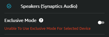

Qobuz will completely fail to play 44.1 kHz content when using exclusive mode.
Are you talking about streaming 16/44.1 or playing local (purchased / downloaded) tracks? I ask because I've had no issues with the Qobuz app (when I use it) playing 16/44.1 streams, or even switching between different resolutions in a playlist. My DAC shows the difference using different LED colors behind the volume knob, so I can see that it's changing as it should.
rkw
It has a sound card that only supports one resolution? What computer is it?on one computer I have that only supports 48 kHz (not even 44.1 kHz), Qobuz will completely fail to play 44.1 kHz content when using exclusive mode.
Lenovo L13 Yoga. You get to choose the bit rate, though! See, there's always a choice!It has a sound card that only supports one resolution? What computer is it?
Streaming. I've only had this issue on this particular computer when trying to use the built-in DAC, which only supports 48 kHz, nothing else. But it turns out that's not the issue...Are you talking about streaming 16/44.1 or playing local (purchased / downloaded) tracks? I ask because I've had no issues with the Qobuz app (when I use it) playing 16/44.1 streams, or even switching between different resolutions in a playlist. My DAC shows the difference using different LED colors behind the volume knob, so I can see that it's changing as it should.
When I try to use exclusive mode with this DAC, I get the error "The selected device is not recognized by the application."
However, Amazon Music has that same problem. "Unable to Use Exclusive Mode For Selected Device".
So much for my theory about why Amazon might not want to set the sample rate exactly.
I then tried foobar2000, which gave me "Unrecoverable playback error: Device in use". Hm!
After some tinkering, producing the same errors with another DAC if something else was already using it in exclusive mode, killing all kinds of processes that may or may not be using the internal DAC already, I eventually turned off the checkbox next to "Allow hardware acceleration of audio with this device".
Tada, exclusive mode now works, in Qobuz, Amazon Music and foobar2000. Both Qobuz and Amazon Music actually happily play any sample rate through it, whether it's 44.1 kHz, 192 kHz or anything in between. I would not have been surprised if they are limited to 48 kHz and refuse to play anything else, which is what foobar2000 does.
Especially interesting that Amazon Music plays a high quality track and downsamples it instead of what it used to do, namely pick the lowest quality that is still supported by the hardware and upsample it.
Well, mystery solved.
