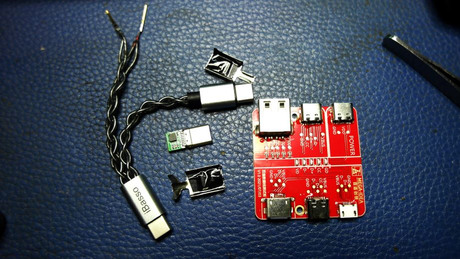

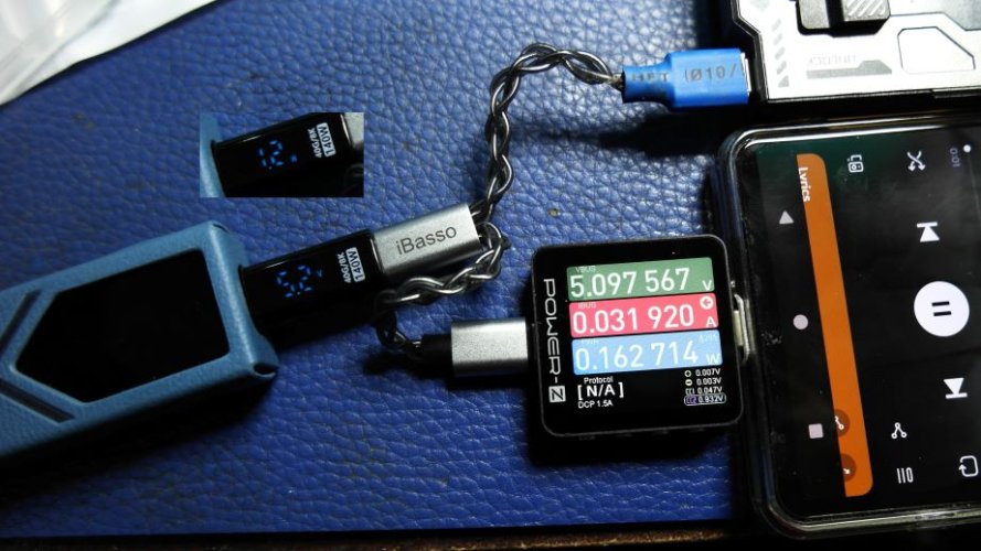

  23. iBasso CB19 C-to-C cable mod for Type-C PD power source Post 177
