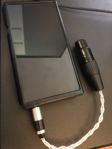

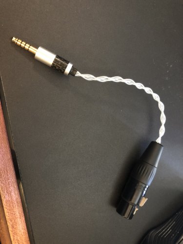

Some pics of the DJ44B if anyone is curious on the size. It does stick out quite a bit but I believe for wiring reasons it has to be that way.

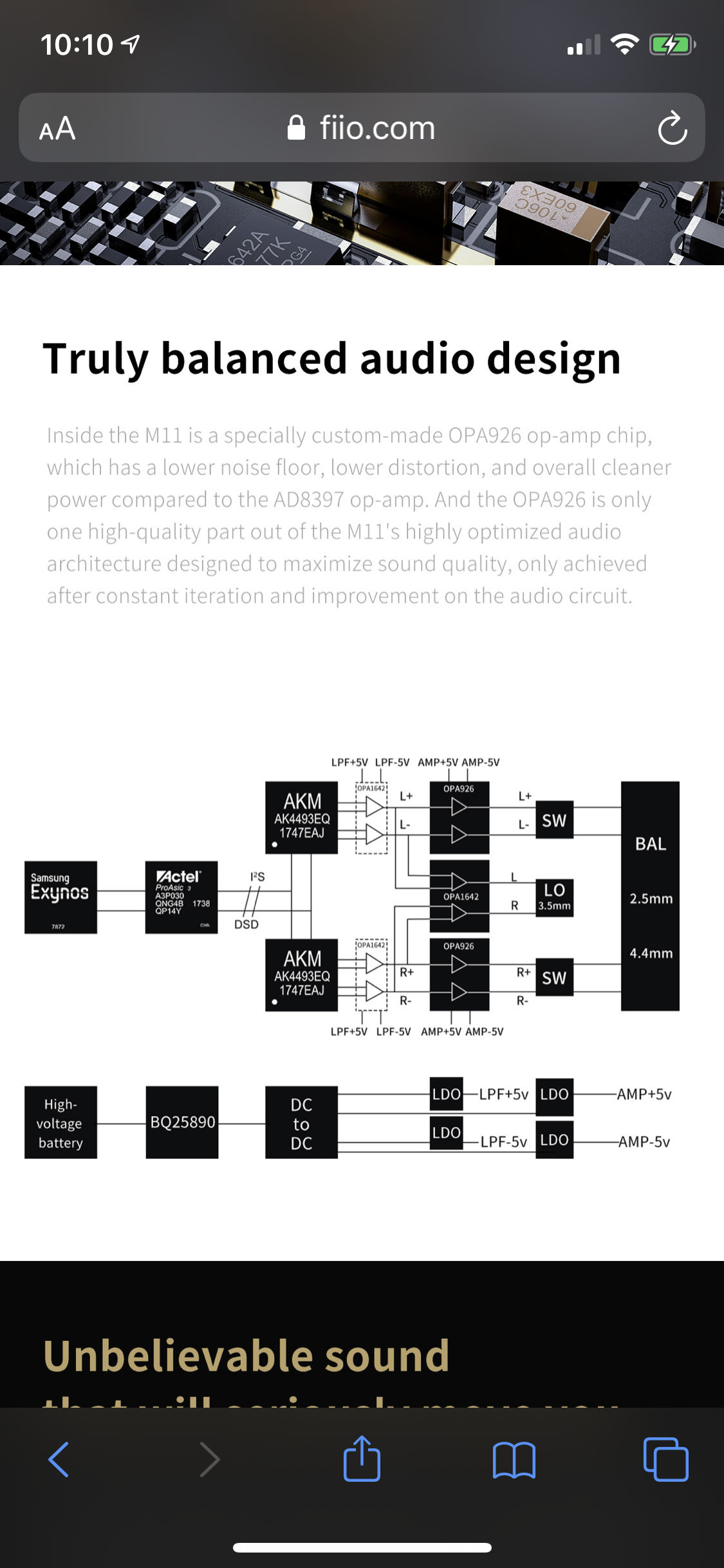

Just to be clear, if you want the benefits of balanced, the only way is to connect it to a balanced source?
For someone who wants as minimal of a setup as possible, I know there's the iFi Zen DAC, but I was wondering if a dongle would be feasible. What I'm hearing is that at least for the 3.5mm jack, an adapter would kill the effects of a balanced sound.
However, I'm wondering if it's theoretically possible for there to be a USB A or USB C to 4.4mm balanced pentaconn, just like Audioquest does with their usb dacs? There's a usb C to 2.5mm balanced dongle: https://www.amazon.com/iBasso-Audio-Balanced-DC01-Products】【Ships/dp/B07X2J9F1C, but I don't see anything for the 4.4mm. In the above linked product, is that still balanced output?
Much thanks :)
That is correct. With the ground wires being grounded together it means it’s single ended only. The other part is that the balanced jack you plug into is using two dac chips instead of just one like with a single ended set up. FiiO has a diagram showing how they wire their dac chips to each jack.
You probably won’t see anything in 4.4mm for a bit. While I think the 4.4mm pentaconn connector is fantastic, it’s not as cheap to get the jack as say a 2.5mm jack. The 4.4mm connector is still fairly fresh and companies are slowly switching to it. Also the 2.5mm has been around way longer so it appeals to those of us who had old cables who don’t wanna buy a adapter to 4.4mm. We now have the ddhifi adapters. Before we had to usually buy interconnects made by the cable companies we used to make sure we had the exact cable material and no sound changes if an adapter had a cable between the connectors. For a lot of people the switch to 4.4 wasn’t worth it back then but much better now.
