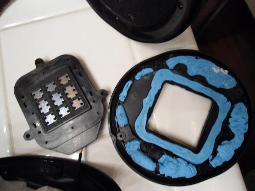

UPDATING PICTURES
The full thing
One pad off.
Both pads off. Left is towards head. Right is towards cup.
Removed driver felt. Just took driver out of the holder and slid knife through the felt for a clean cut
My headband holding system. Just removed the headband and slid the system over it.
Rear of driver.
That dampening dot is from somewhere. Don't remember where though. Controlled everything a little better though. Blutack on the inside too.
Blutak (not blue) on the inside. Not too pretty but doesn't matter. This is three stick rolled out with a rolling pin and the center cup open. Lay it across the with vent viable. The vent frees some bass, but also gives the driver more control of it. What's better? More bass or better bass?
To show I applied duck tape over everything on the inside to clear the plastic harmonics
Center of the driver port is blutak in a mm thin stretch to replace the felt that was there. I think this actually did something, maybe more clarity and cleared up some rattle. But not too sure.
To show how thick my pads are. That is a upside down 2, don't ask, it's a mechainist's ruler. It's just over 1 1/2 inched in width
The completed T50RP modded to a LCD-2's specs.
Enjoy the picks and don't think it's rude to ask questions.

All parts of the spectrum improve by removing the white felt and replacing it with a stiff craft felt...  this requires tuning the vent to reduce the then huge bass output, but it works incredibly well.  My $.02 is this will take your mod even further, but the caveat is it is not reversible.  I have built 5 pair and done significant A/B time, and there is no comparison.
Also, BluTak can be improved on by using plasticine.  It is way denser and better at mass loading the baffle and killing resonances in the plastic.
I'm curious why you chose to damp the back cup with blutak instead of using foam to kill reflections.  Did you A/B?  What was the result?  Or have you only tried it this way?
Loved the hand-made ear pads and band.  Wish I could sew leather (probably just need to try and be willing to thread my finger a few times)...  :)
