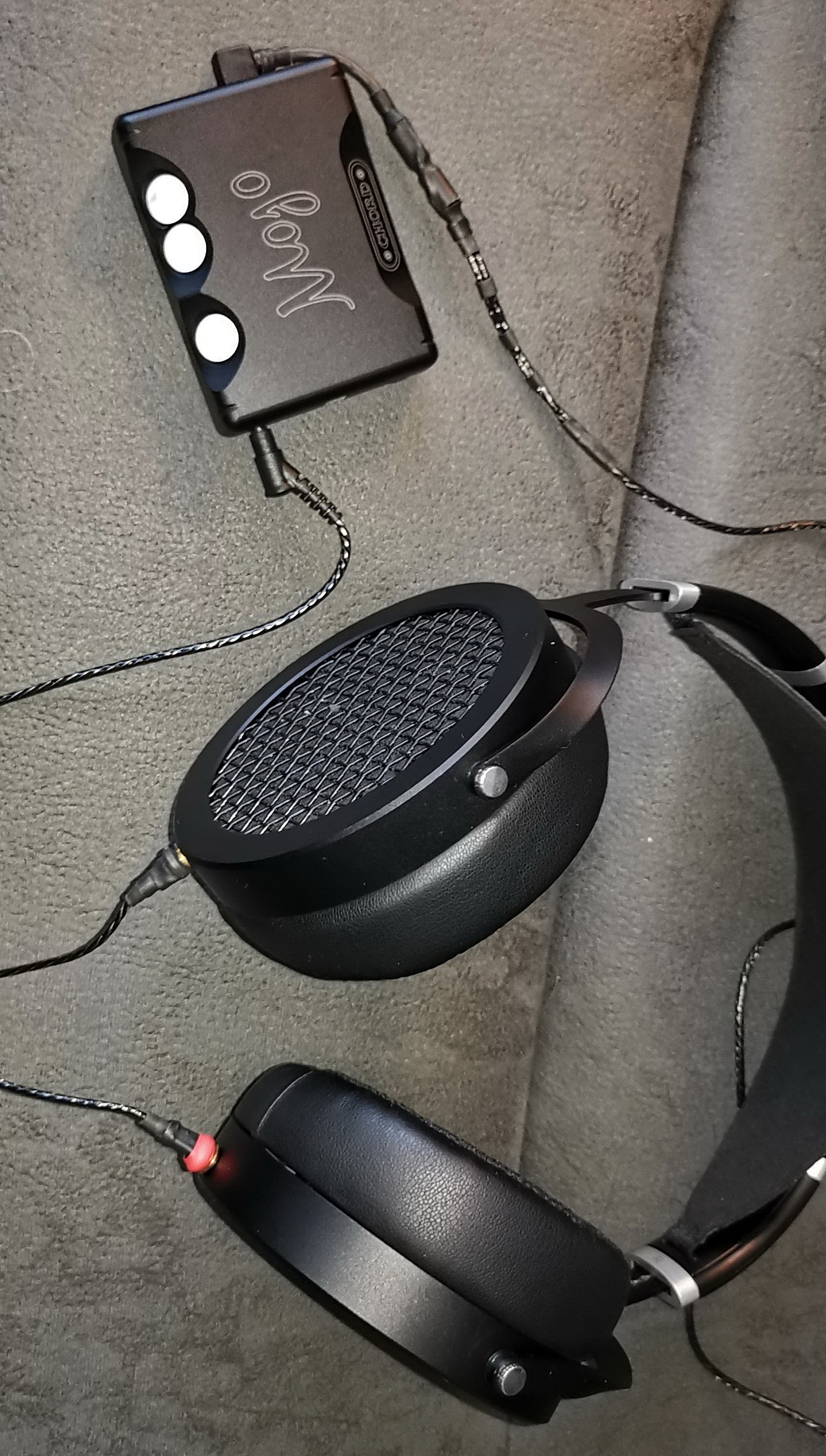

A question for Mr. Watts @Rob Watts .
I Use my Mojo with my mobile phone exclusively.
I was fortunate that I never noticed the effects of RFI on my sound, but a change of headphones means that now I can hear it, ain't ignorance bliss!
I make my own USB interconnects and they are long (1 meter), so the phone never comes close to Mojo.
Here is the question:
I am about to use some RFI blockers on the cable, my choices are small radial ferrite chokes, common-mode ferrite chokes and small capacitor built and heat-shrunk sleeved into the cable, near Mojo end.
How is the RFI affecting Mojo? is it on the ground and 5V lines? id it affecting the data lines? both?
I was thinking of a CM choke on ground and 5V line and a small capacitor afterwards, would that be enough? or do I need chokes on both ground and 5V lines and a CM choke on data lines?
I appreciate your reply. If anyone knows, it is you!
Oct 13, 2021 at 2:11 AM Post #2,723 of 5,075
I wouldn't try making your own USB cable, as it has to be impedance matched - I would stick too certified USB cables. Many audiophile USB cables are engineered to increase RF noise, making them brighter sounding. Quality audiophile USB cables sound the same as generic certified cables...
The situation is RF current flow from the source through the DAC into the DAC's ground plane; this can only happen if the source is grounded, and Mojo's output is grounded too. So a battery operated source will not create these currents. Mojo also has ferrites built into USB ground, to attenuate these currents too.
I suspect that your real problem is your new headphone, and nothing to do with RF. My DACs really do make the differences between transducers much more apparent, as the DACs fundamentally have little of their own sound signature, making it a lot easier to hear problems with your headphones. There are a lot of devices on the market that have high audiophile reputations, but actually have serious sound quality problems.
If you want to rule out RF as an issue then try an optical source. If it sounds the same as USB with generic certified cables, then it's definitely your new headphone.
Oct 13, 2021 at 3:39 AM Post #2,724 of 5,075
Unfortunately what I require I can not buy pre-fabricated. But I did try standard cables, they did not fare any better. they are bulky, and I also would need a USB-C OTG dongle, which makes the whole contraption way too big.
The situation is when I put the phone in full plane mode (all transmitters off) the effect goes away, am I imagining it? don't think so. when the phone is transmitting, different cables make a difference. I have made a few, two are pictured below.
The one with just a simple ferrite cylinder makes a tiny improvement, the other with two multi-turn ferrites (one for ground, another for 5V) has made the largest improvement. phone on plane mode has the highest effect.
Headphone is a Hifiman Sundara, which sounds pretty good with phone on plane mode and the better cable.
I do not have that option with a phone, but a PC optical sounds same as phone on plane mode with the better USB cable - but only to my ears, and not in a quick A/B test.
Lastly may I thank my lucky stars, that I can get answers from designer of my equipment, this is really rare! and appreciated.
Thank you @Rob Watts for taking the time at 7am to reply.
