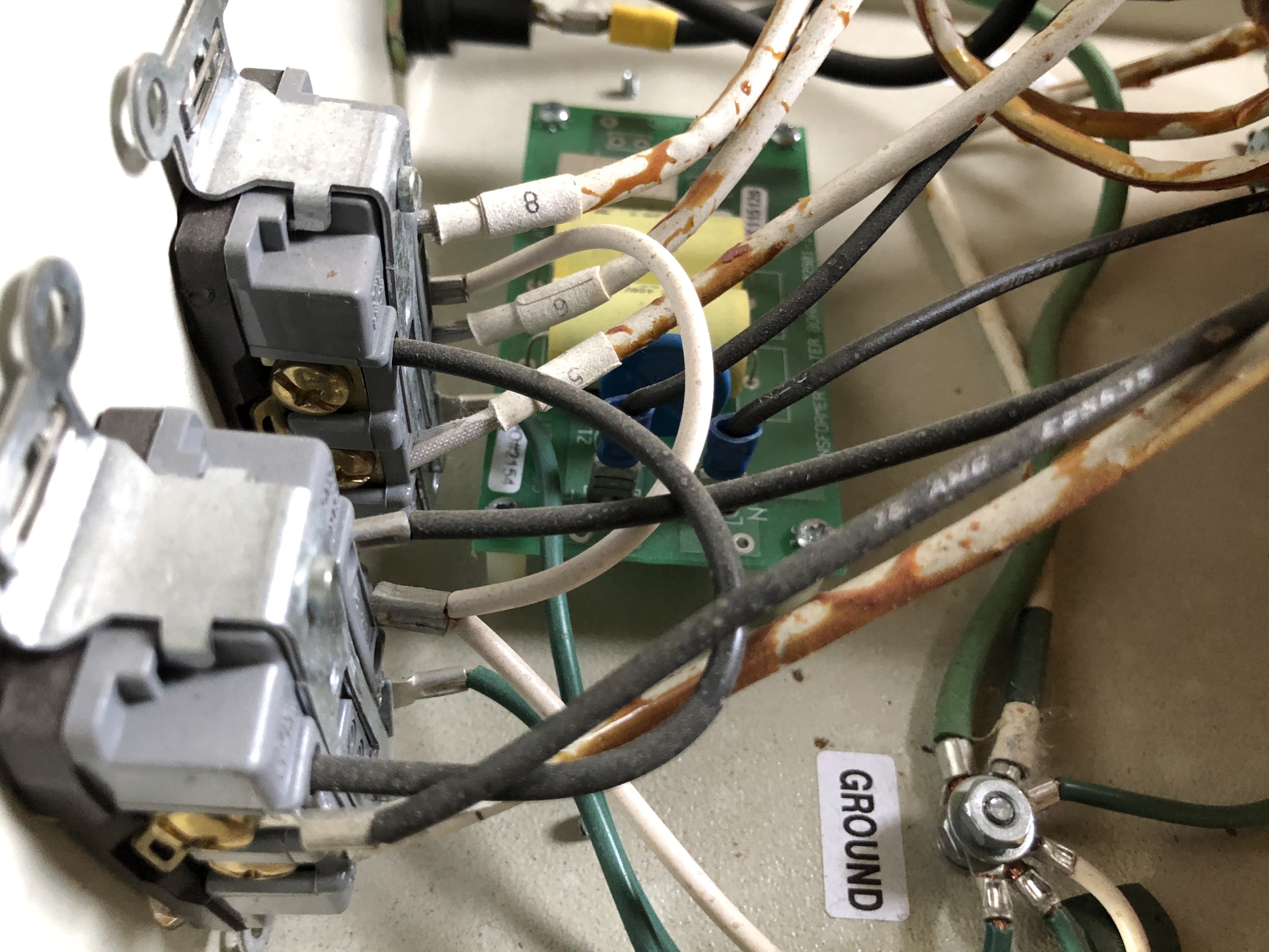

I just re-terminated the plug. I’d rate the magnetostriction transformer noise as on par with the large unbalanced -31 and -32 transformers. Makes sense considering the multitude of vents means the core isn’t well sealed from the air outside the enclosure.
Aug 27, 2020 at 5:00 PM Post #505 of 569
Based on the photos (since I closed the case up) it appears the T100R core can be wired for balanced power if so desired. My guess is this allowed the manufacturer to use the same core for both the T100R and T100H models that corresponded to each other.
I plan on testing this out and wiring one a T100R for balanced power. If it works out this opens up a new avenue of isolation transformers for Topaz/MGE seekers that prefer balanced power to unbalanced power.
Aug 29, 2020 at 6:18 PM Post #506 of 569
Confirmed: The T100 R can be wired for balanced power just like the -31 and T100H. The magnetostriction transformer noise has now subdued to the point where it can only be heard from 6” or less from the core with the case off.

Wiring instructions (the wires were labeled with numbers)
Original wiring:
1/3 were tied together with the hot wire coming off the fuse
2/4 were tied together with the neutral wire coming off the cord
5 and 7 attached to hot side of receptacle
6 and 8 attached to neutral side of receptacle
Balanced power wiring:
1 goes to hot wire coming off the fuse
2/3 tie together
4 goes to neutral wire coming off the cord
5 attaches to hot side of receptacle
6/7 attach to ground
8 attaches to neutral side of receptacle
REMOVE WIRE GOING FROM NEUTRAL RECEPTACLE SIDE TO GROUND
Ground to 5 should measure 60VAC
Ground to 8 should measure 60VAC
5 to 8 should measure 120VAC
None of the input wires should measure as a short with ground
