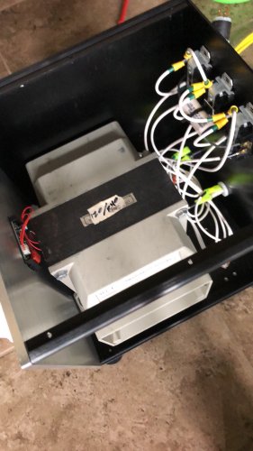

@L0rdGwyn the cases can be found on eBay. It’s hard to find them now because all of the sellers on “away” which pulls their listings from the search engine. Here is the listing for a case the same size as the one I sold.
https://rover.ebay.com/rover/0/0/0?mpre=https://www.ebay.com/ulk/itm/302660809662
While that case worked for my -32 2.4kVa I had to shoe horn it in by cutting transformer narrower and shorter. You have the 2.5kVa -31 which is 0.9 longer and won’t work with the above listing without extreme cutting. Maybe not event then.
When the sellers come back from what I suspect Chinese New Year holiday try searching for “300 311 aluminum.” It should yield some results of cases like the one below. That may just barely work for your increased length without cutting. These cases measure 300mmx300mmx311mm. Expect to pay about $160-170 shipped. I turned my transformer sideways to make it fit. You may or may not be able to do that. The listing will have the internal dimensions posted.
7A0AF9DB-2C30-4165-A4B0-D6DE52612FA0.jpeg 38C0C367-A8C3-49D6-8AD0-793DB97A5D42.jpeg
Here is the first case next to a the same jug for comparison
The next larger cases can be found by searching for “356 aluminum enclosure” these are 356mm long and will definitely fit your transformer. These cases measure 300mmx300mmx356mm. I believe they are about $25 or $30 more than the 300x311 case. Your transformer will fit with no cutting running lengthwise.

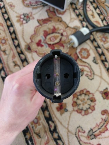

My 91002-31T arrived today. Holy cow this thing is a BEAST. Not sure I am comfortable carrying this more than a foot off the ground, pretty sure if I dropped it it would go straight through the original floor of my 1920s home :sweat_smile:
Here is a pic:
Interestingly, it is wired for 120V on the primary, 240V on the secondary and has a Schuko connector on the secondary side. Must have been used with some European equipment in its life.
Primary wiring:
Secondary wiring:
Going to have to do some rewiring before I can even test it, either go full balanced right away since I'm partway there or revert to 120V in and out. Might have a connector lying around somewhere to replace the Schuko, or I could order an adapter to test just in case there is a problem, seller was very flexible about returning if there is an issue. I did test for primary to secondary shorts at least, no issues there.
