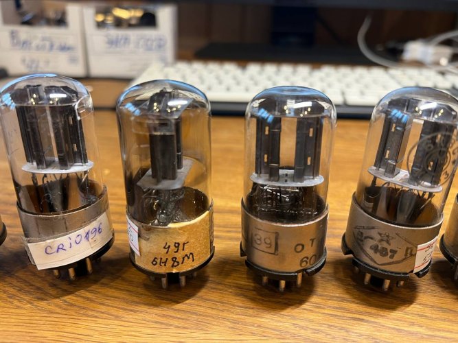

No one has ever made stainless steel pins!
These are options for copper tubes of different wall thicknesses with different types of coating
I know this for real (I am attaching a photo - these are dismantled MELZ tubes from 50 to 89, which I use in my work!
Therefore, some of the posts on resuscitation of pins and soldering of wires on this thread really puzzled me!
I have attached a photo of the current collection, but this is just the beginning!
Yes! and the fact that someone rolled up "Brimar" on ordinary 6N8S ($3-9 per piece depending on the quality of the matching) from the Novosibirsk (NEVZ) plant of the 1980s - this is only marketing trick.
Pure modern marketing - nothing to do with reality

I dont quite get you...I am really confused with that statement. Below is a pair of MELZ 6N8S / 6H8C, made in 1956, I used to have.I would like to give you some information that (I hope) will be useful not only for you!
Yes, you definetely have a 6N8S tube from the MELZ plant produced in 1976 with a perforated anode (round holes).
Also on the tube there is the sign "1578", which indicates that this is a batch of 6N8S intended for the nuclear industry!
However, this statement is not 100% correct! Since 1949, tubes have been found only with "1578" and without "6N8S"

Please excuse me for misleading you. Unfortunately, I speak English very poorly and use a translator to write posts.I dont quite get you...I am really confused with that statement. Below is a pair of MELZ 6N8S / 6H8C, made in 1956, I used to have.
In the sentence you highlighted, I meant that since 1949 there have been tubes with different markings. Some have only "6Н8С" on them, some have only "1578", some have both inscriptions. I have attached photos of similar examples with highlighted captions to this post.
Based on the Soviet documentation I checked and the evidence of those years, my main version at the moment is as follows:
6H8C is the name of the tube model itself. It appears in the technical documentation for this tube of those years. It was this name that was used as a designation.
"1578" is most likely NOT the designation of the model, I could not find such an index in the technical documents of the manufacturer's factory.
"1578" is most likely the acceptance stamp, or the stamp of the customer of certain batches of 6H8C tubes supplied to a certain enterprise or purchased by a certain department (probably the Ministry of Atomic Energy)
Most likely, the tubes bearing the stamp 1578 had additional quality control from the customer and/or during the production process.
In my collection there are examples of tubes that at first glance do not have the inscription 6Н8С, but at the same time there is an inscription 1578. But upon closer examination of the tube glass, you can see signs of the erased (over time) name 6Н8С.
I assume that due to the different technology of not applying these two stamps, after many years there were a large number of tubes on which the stamp “6Н8С” was completely erased, and “1578” remained. This is what "created" the new tube model, although this is not entirely true.
