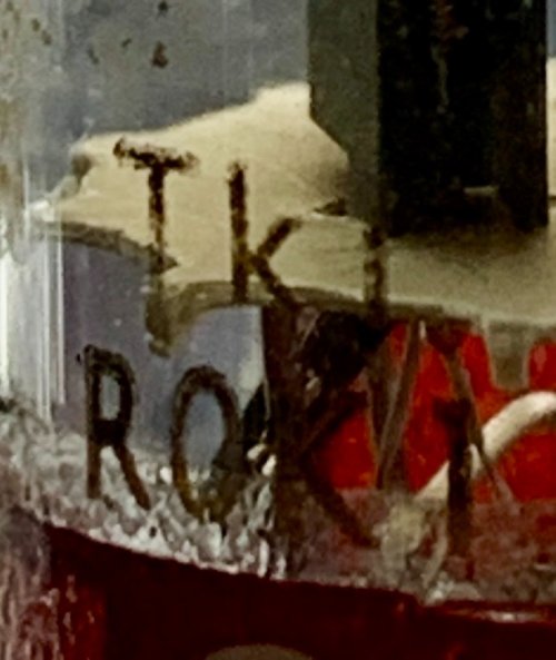

The famous Genalex Gold Lion vacuum tubes were the exact same thing. All Mullard production, with Mullard/Philips production codes for normal ECC81-82-83 etched on the tubes themselves. Collectors pay extremely high prices for these NOS Gold Lion tubes with B749 or other GEC code; thinking they are GEC.
Here's samples ECC81, 82 and 83 in "Gold Lion" versions. (Click on small pictures below post to see date codes on others. They are hard to read but say:
TK -> ECC81; GF -> ECC82; I6 -> ECC83
Same story with CCa tubes instead of E88CC tubes. People tend to think they are totally different tubes. Instead they are just the exact same tubes as all the rest from the production line. It maybe they were selected to a certain standard and printed CCa as sellers claim. It could also be they are reprinted normal E88CC. They share as an example the exact same (In this case Telefunkens) datasheet: https://frank.pocnet.net/sheets/128/e/E88CC.pdf
And what's even more confusing is that Genelex KT88 were indeed made my GEC (for export). GEC didn't want @bcowen confusing the GEC tubes with GE tubes.
