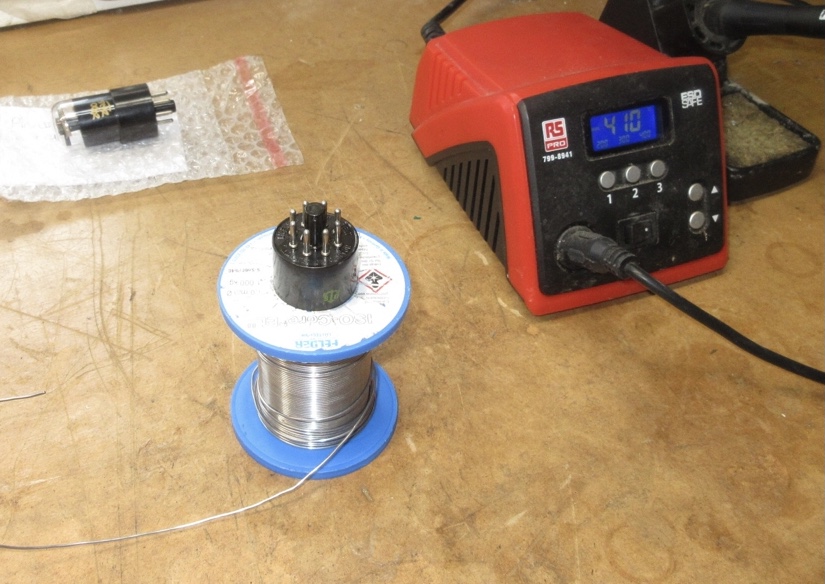

Here’s a nifty way to hold your 6sn7 tubes when soldering! When held in a vice or wedged on it’s side, simply rotate the tube to the next pin!
Not my idea bye the way.
I keep the tubes horizontal, I prefer solder not run all the way to the glass and capillary action draws it in just fine.
A nice way to hold the tube nonetheless. Many of the tubes I replace the solder on are worth $250 up so I am pretty cautious. I might take less care with Fotons.🤪🤪

So just how much solder is enough? Just a couple mm? I'm guessing filling the entire pin is overkill

Here is my high tech tube holder----make the base angle anything that you need!
I generally go about half to three quarter of the way in. I use small diameter solder that fits inside the pin so I can gauge how much goes in. It is rosin core of course and I have already put a drop or two of liquid rosin flux inside each pin to cleanse the metal.
