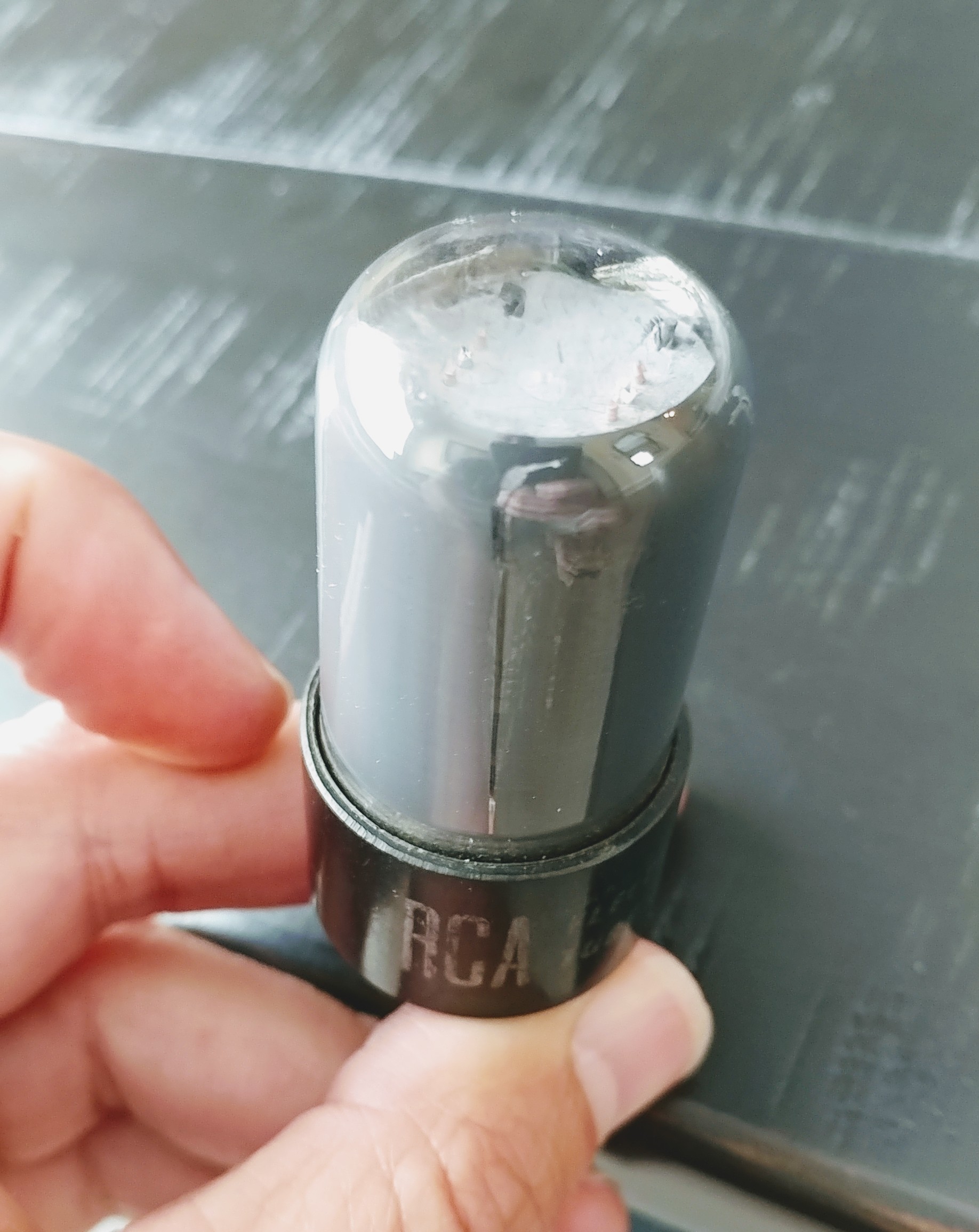

At what Decade did Sylvania take over tube production.., it seems like EVERYTHING was made by Sylvania..lol, I spent some time this morning looking up what I thought was a date code.. 722... turns out it's a manufacture stamp..yes, Sylvania. A RCA 231 replica? Sounds good, just (I shouldn't be) surprised. :D
