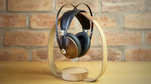

Hi all,
I came across this, it’s a small Kickstarter project, so not really DIY but not fully commercial either:
https://www.kickstarter.com/profile/backings/83842118
(by the way, is there a commercial headphone stand thread? I can’t find one, which seems weird how fanatical the head-fi community can be!)
I started another thread for it here, with more info:
https://www.head-fi.org/threads/the...ne-stand-on-kickstarter.904464/#post-14895123
Looks awesome, I’m hoping it’s funded so I can get my hands on one. If not, I might try a similar design myself - I’ve made quite a few pieces of wooden furniture but nothing involving curved wood like this before. So yeah, my DIY effort is unlikely to match the quality here

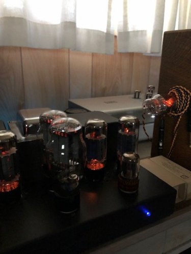

Lighted tubes with a hidden switch, all batteries, tubes, LED's are accessible and replaceable. No tubes were damaged in the making of this stand as well.
Neat Idea Tom.
I now know what to do with the dead Tungsol 5998 (has a short) that has been sitting in my draw for a couple of years now.

I have tried various headphones on the stand and have had no issue with breakage. Tubes are stronger than you might think and most of the force is on the octal socket and the older tubes use bakelite or such that is very strong.
The Tung Sol 5998 would be a perfect tube for the large tube in this build. I drill a hole in the base of the tube location key, making sure not to go too far and hit the glass. I found cases with switch for dual 2032 batteries at right at 6 volts, and I run two, three volt LED's. No wiring is visible and on the back side I left access to the on off switch. Jamie with your skils you can certainly figure out how I did all the wiring inside the wood but if you need pointers PM me.
I did use a touch of hot glue to be sure the large tube stays in place, I can use a heat gun to remove the tube if I want to change it out.
This photo shows the notch on the backside of the stand where the on off switch is located. I need to clean that up a bit but it is accessible and works well.
You would think amber LED's would be correct yet orange matched my amp tubes better.
