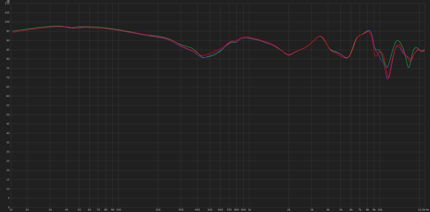

I stumbled upon this thread. I love my TH900mk2, and its sound signature. I was skeptical of the “foam discs placement mod,” but curious. I just tried it today and it absolutely works. I’d say that I probably gain about 8-10% more bass on position #3, which was a pleasant surprise. Great non-evasive and easily reversible mod! Thanks!
