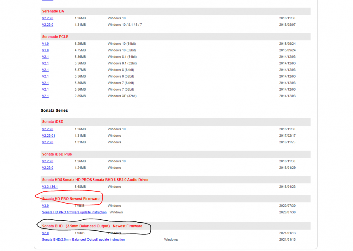

I just received it and it doesnt work in the computer/phone, what could be the reason? I tried to update the firmware.
What is "it"? Are u referring to the Tempotec Sonata HD Pro?
If so, please check that u downloaded the latest firmware. Go to this link: https://twitter.com/Sales2019tempo1/status/1289096596752412672?s=20

After ensuring latest firmware is in place:
1)
For phone use, are u using an android phone? You need to have an app that can bypass the android DAC such as Neutron player or HibyMusic App. Then go to settings and select exclusive USB access/bit perfect output.
2)
For windows use, make sure u have a USB A to C adapted and plug it in, then right click the volume button at the bottom right of task bar -> "open sound settings" -> scroll down to "sound control panel". Right click the tempotec sonata HD pro icon, go to properties -> "advanced" -> set the default format to the highest setting and save it.
