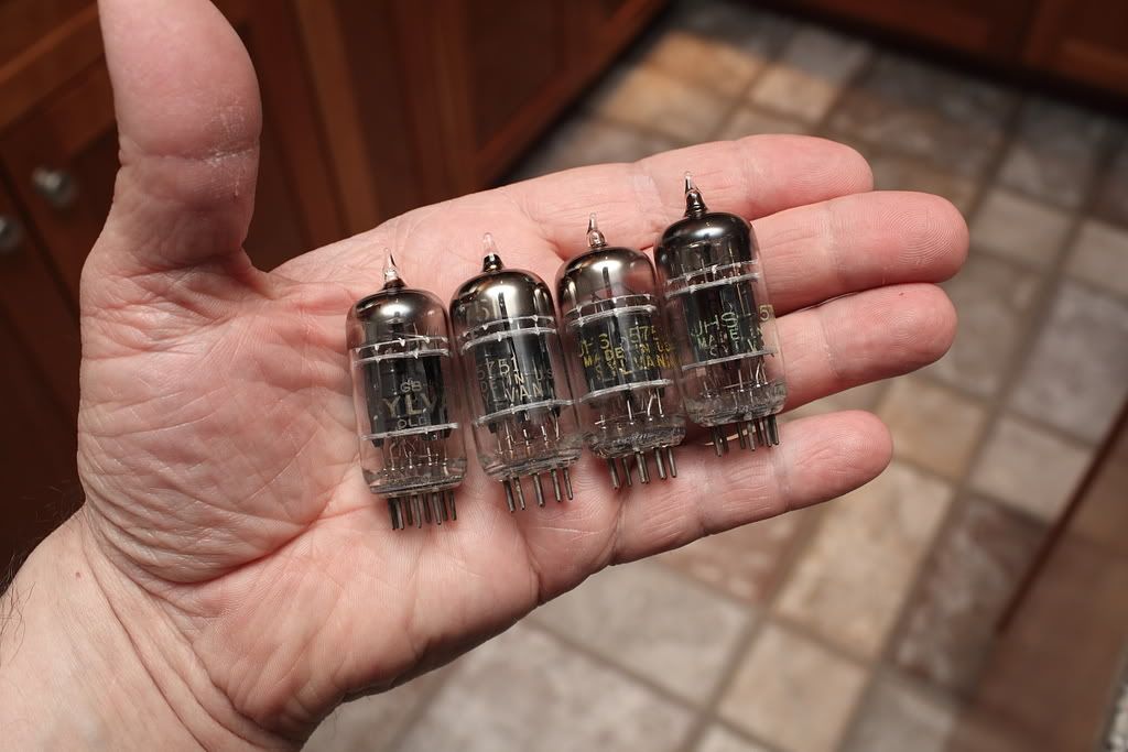

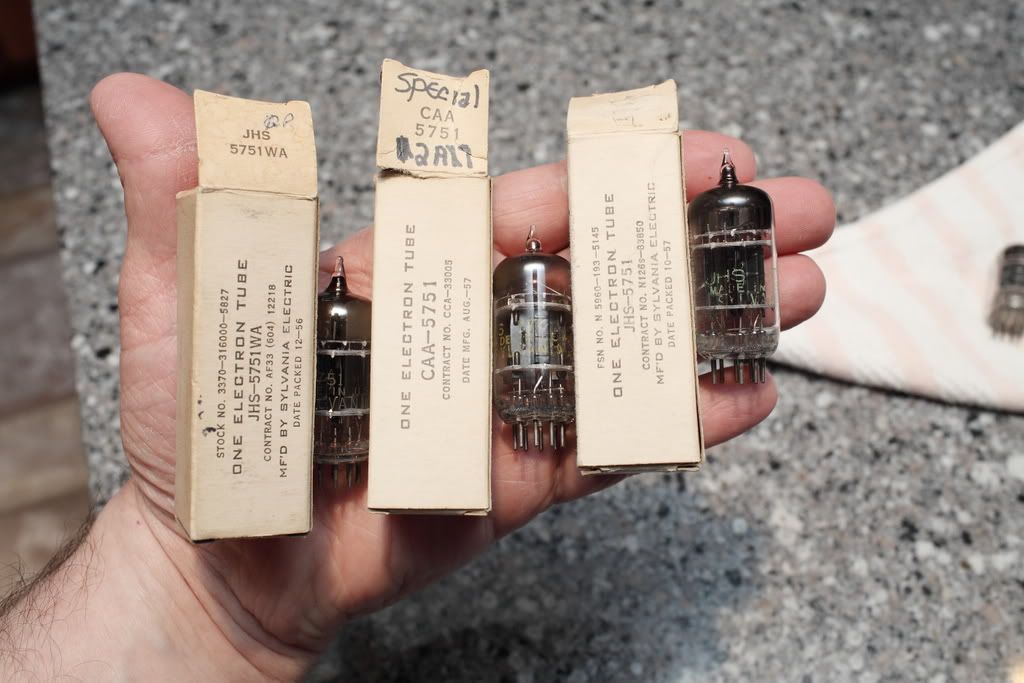

I never said labels = labels (meaning JAN = GB)
When I made those posts back in the prehistory of the AA forum I was referring to the older black plate 5751s. These were made back in the 50s and could have a variety of labels - GB, CAA, JAN, JHS, etc. The thing you need to look for are tube structures and plates. What I called triple mica (like those in the pics below) - with a third mica spacer near the top of the tube which the getter wire touches - and black plates. The later Sylvanias with grey plates, and no top spacer generally sucked. The grey plate gold brands with the top spacer are pretty good, but I still think the black plates are the best.
A sample of black plates ranging from gold brands to gold CAA labels to yellow and green JHS labels are shown below. All are identical in manufacture and sonics....
Joe
Mar 9, 2009 at 12:37 AM Post #28 of 86
Thanks! Those are excellent pictures for comparison, very useful. Yes, I'm definitely focused on this black plate version, now just gotta find one out there...

My Sylvania looks almost exactly like the second tube in the second pic.
As for the Raytheon, it has grey plate, yellow lettering and logo with no spacer on top.
How do I identify if it's double or triple mica? Where is the getter located? I'm obviously a tube noob!
