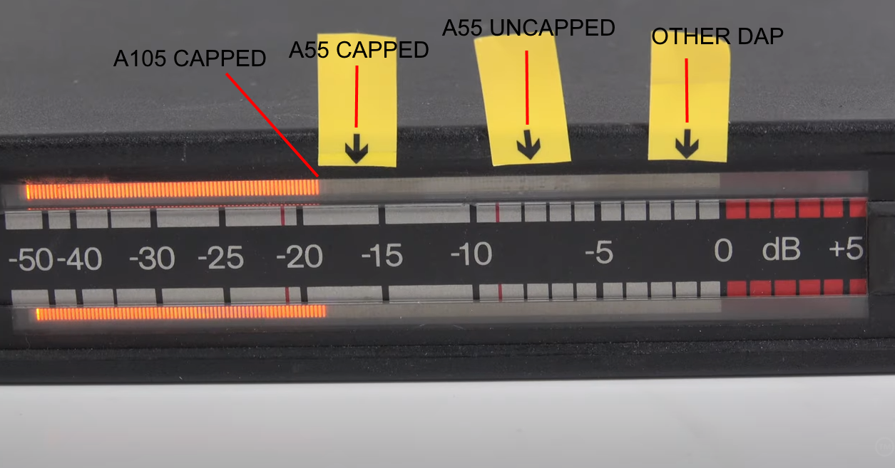

I have the European a105 in firmware v3.0 and the sound is very comparable to a a55 without volume cap. I think they removed the volume cap(or at least reduced it significantly) in the newer firmware versions..
A105 capped has a lower volume than A55 capped, actually. In the video, he mentions that the volume is the same after the latest firmware update of the A105.
The image is from this video:
As per the volume cap being removed or not upon installing a firmware intended for another area, the thing is that the volume cap is region dependent, and the region is not actually changing upon installing another firmware. That region/destination has to be changed intentionally with a command, and it's stored in a place similar to how it's stored on the non-Android Walkman players. Once there will be at least root access, then the region could be changed.
