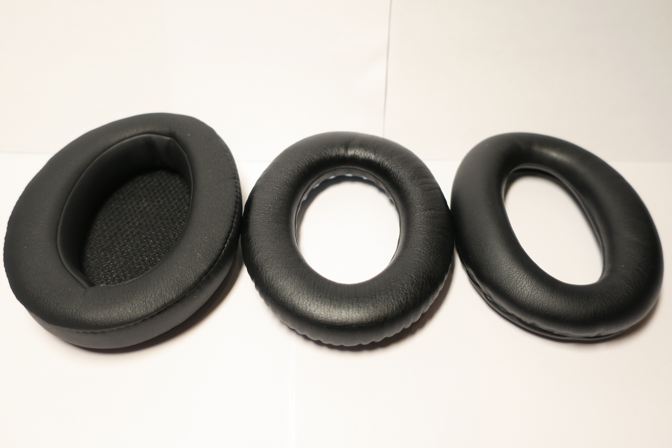

So I wanted the best of both worlds. I wondered if I could try the Bose earpads on the Sony's, and it turns out they are an almost exact fit. I tried the Bose earpads on the Sony's and immediately were more comfortable, but not deep enough as my ear could still touch the foam. I researched on the interwebs for replacement Sony earpads and found nothing. So I searched for replacement pads for Bose, with the criteria that they needed to be a bit deeper and at least as wide. I found these by Dekoni Audio that fit the bill:

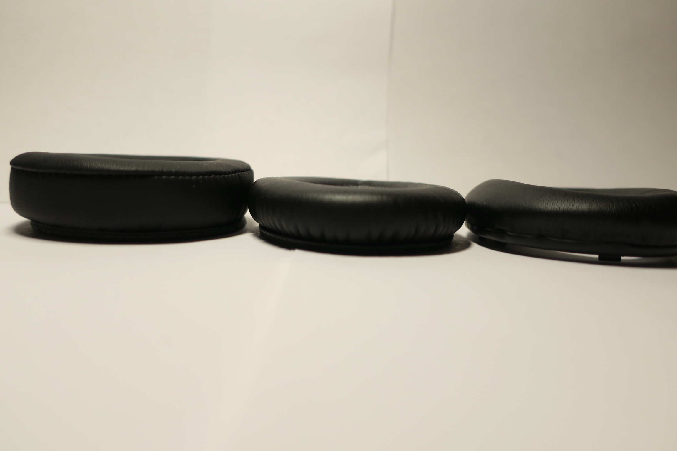

Here they are next to the Sony's and Bose. Notice how they are a bit deeper, wider and taller:

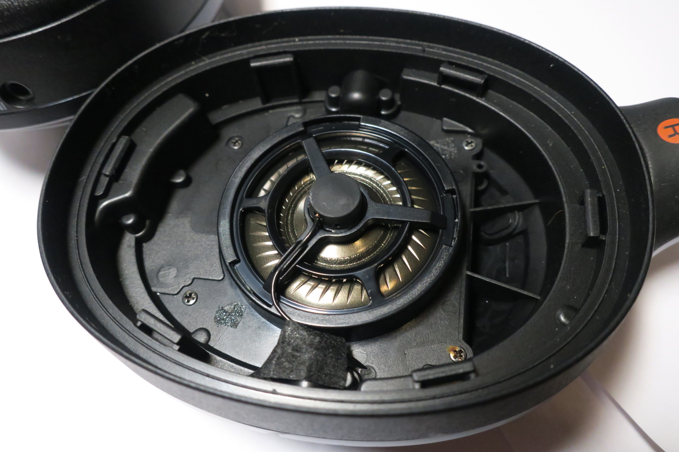

The sony earcups are help in place by a removable plastic ring with 6 clips:
I wanted to see if the foam could be removed. It's just help in place by two dots of glue, revealing some foam filling and the driver:

Right away the midrange opened up and the highs were sparkling. However the midbass felt too clinical/shrill and the bass was lacking. Any impact was lost without the filler foam. So I tried the test again, this time putting the filler foam back in place:
The bass is back. However I noticed quite a few empty spots so I tried to fill them further. I used organic cotton pads, two stacked together, about 1 cm in width:
This resulted in much deeper bass and more impacting mids. Also a wider soundstage, probably due to the increased distance to the speaker.

do you feel like the new earpads have made it significantly bulkier? I recently purchased the brainwavz because that was the first recommendation i saw and now i have a football head.
I might try the organic cotton pad upgrade.
Also noticed the cracks on your headband.. Are they getting worse with time? i just noticed i have a crack on mine as well.

I think they are just a tad bit bulkier. Here are next to another pair with the original pads:
I've been comparing them for hours and stand by my recommendations -- the bass increase is substantial and the soundstage less constricted.
