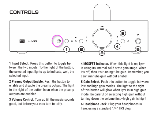

I fixed the button today.
The felt pads glued to the buttons had slipped and are not identical in terms of their hardness. This leads to different haptics for the buttons. After I centered the pads, everything works as it should.
Then I put LED dimmers on the bright LEDs,
so that they don't get on my nerves in the dark.
The LEDs also light up the amplifier from the inside, and thereby spoil the nice light of the tube.
Now the LEDs are no longer annoying, even in complete darkness, and do not illuminate the amplifier from the inside.
Last but not least, the tube got some Caigs DeoxIT Gold to enhance the contacts.
By the way, I am an electronics engineer and I recommend not opening electrical devices.
If I should get problems with the warranty as a result of this action, then so be it.

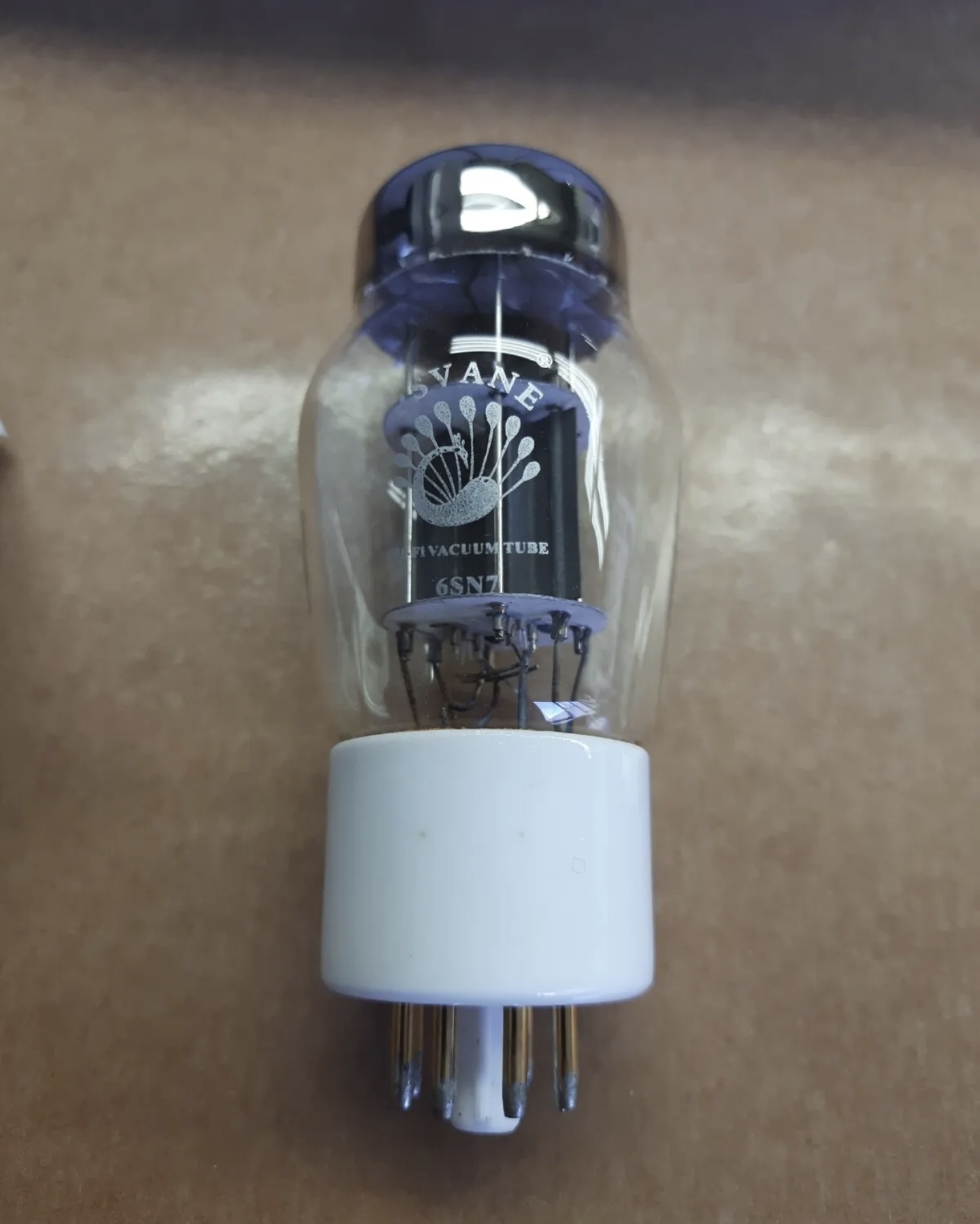

I swapped between the Psvane 6SN7 (non-UK) and Tung-Sol last night and they're pretty close, but I'm enjoying the little extra body that the Psvane has. I think the Tung-Sol pushes back the soundstage just a touch but their actual SS size seems pretty similar.

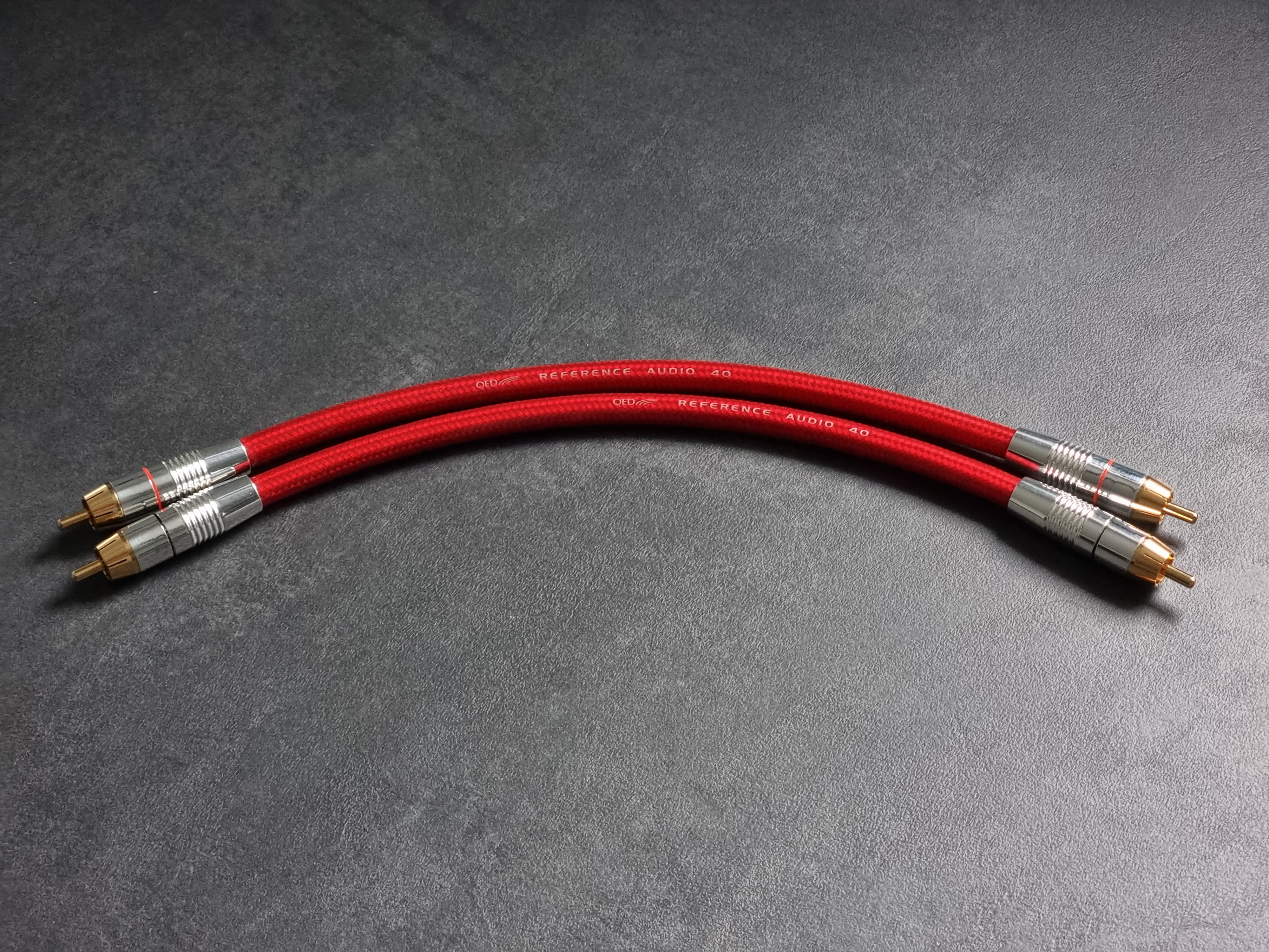

Today I used the lunch break for something useful and built a new cinch cable for the LYR+

The Psvane 6SN7 with my Auteur OG.... Man that is a MAGICAL combination. I've never heard my Auteurs sing like this. It really elevates them.
