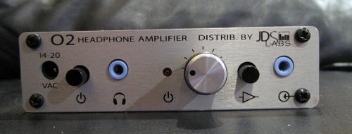

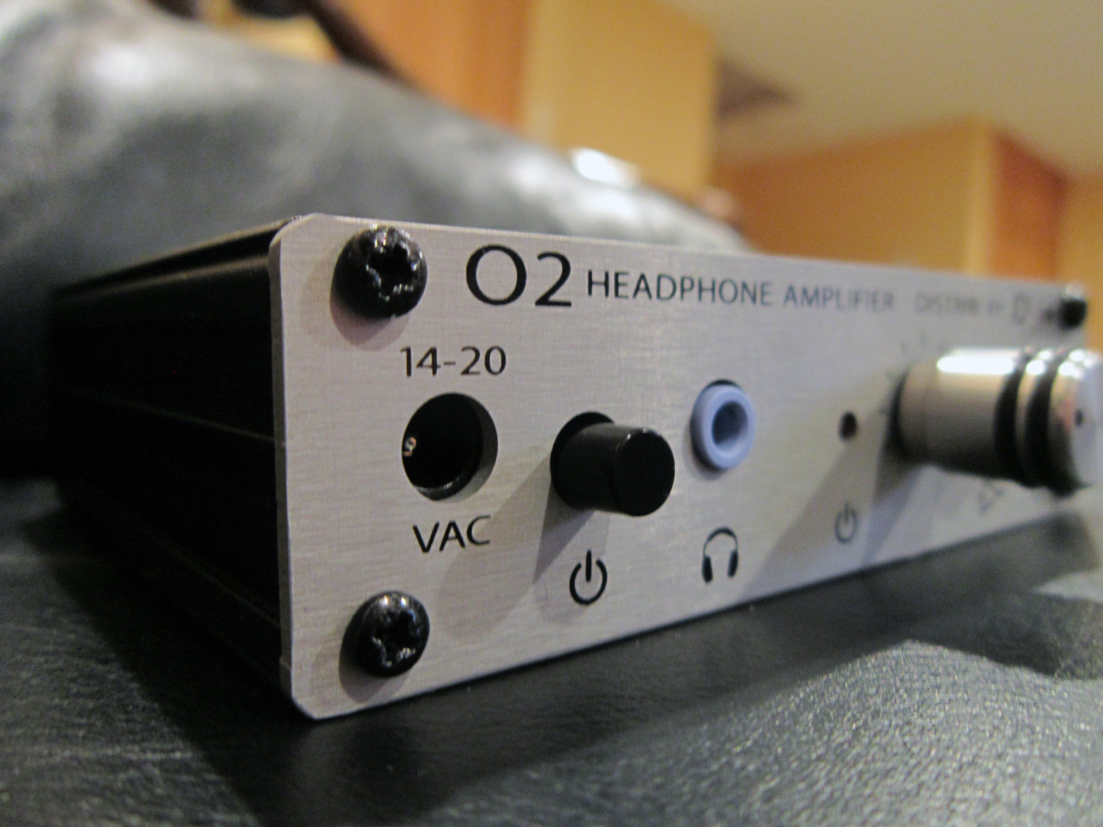

Much like the packaging John shows pride in his work through the careful craftsmanship of the O2 from the inside out. The internals are housed in a two tone aluminum shell held together by four screws on each side. The faceplate is grey with brand and item information on the top while the rest of the body is black. One decision I'm not too fond of aesthetically is the choice to have the power input on the front, I understand that it's how the board is designed though and John built this to specifications. Still it throws off some flow aesthetically.
Every thing on the O2 is on the front, from left to right you have: Power Input, power switch, 3.5mm headphone jack, red LED power indicator, volume potentiometer, gain switch, and 3.5mm line-in jack. Everything feels absolutely solid, the power and gain switch use the same silky smooth switch that clicks to let you know it's been pressed. The volume potentiometer has a nice amount of resistance when turning giving a nice solid feel to it, the double rubber rings are a nice touch aesthetically as well. The 3.5mm jacks are the only thing I have a few gripes about, firstly the light blue throws off the flow of the aesthetics again I wonder if NwAvGuy couldn't have found something black with just as good quality. I also don't like how snug the jacks are, it takes a little more force to plug-in and remove jacks.
