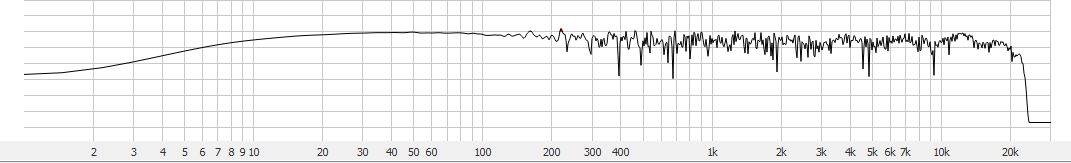

Hello guys, i recently recorded the hrir from my old soundcard connected with an audio interface, my only problem is that i hear all the right channels weird, the left is ok, i don't know if is something related to my ears, can you try for yourself and see if that happens to you too? i attached the hrir

What I see is that you have no headroom in the file. That looks like the recording is clipped. But I did not notice a clear difference between L and R.

I'm not talking about impulcifer. I loaded the file in Audacity and it goes up to 0db. So there is 0db headroom.
EQ-APO shows that the sum for the right and left channels is +29db. With multichannel audio this will easily run into clipping.

yes, i did it on purpose, i started recording the hrir without going below to 0.5 headroom, after that i tried multiple recordings almost below 0 headroom to see if the warping effect on the right channels was fixed, i also tried to normalize the hrir in audacity like in this guide
There's no problem in clipping because i'm conterbalancing it with the preamp -23db in eqapo, as you can see
