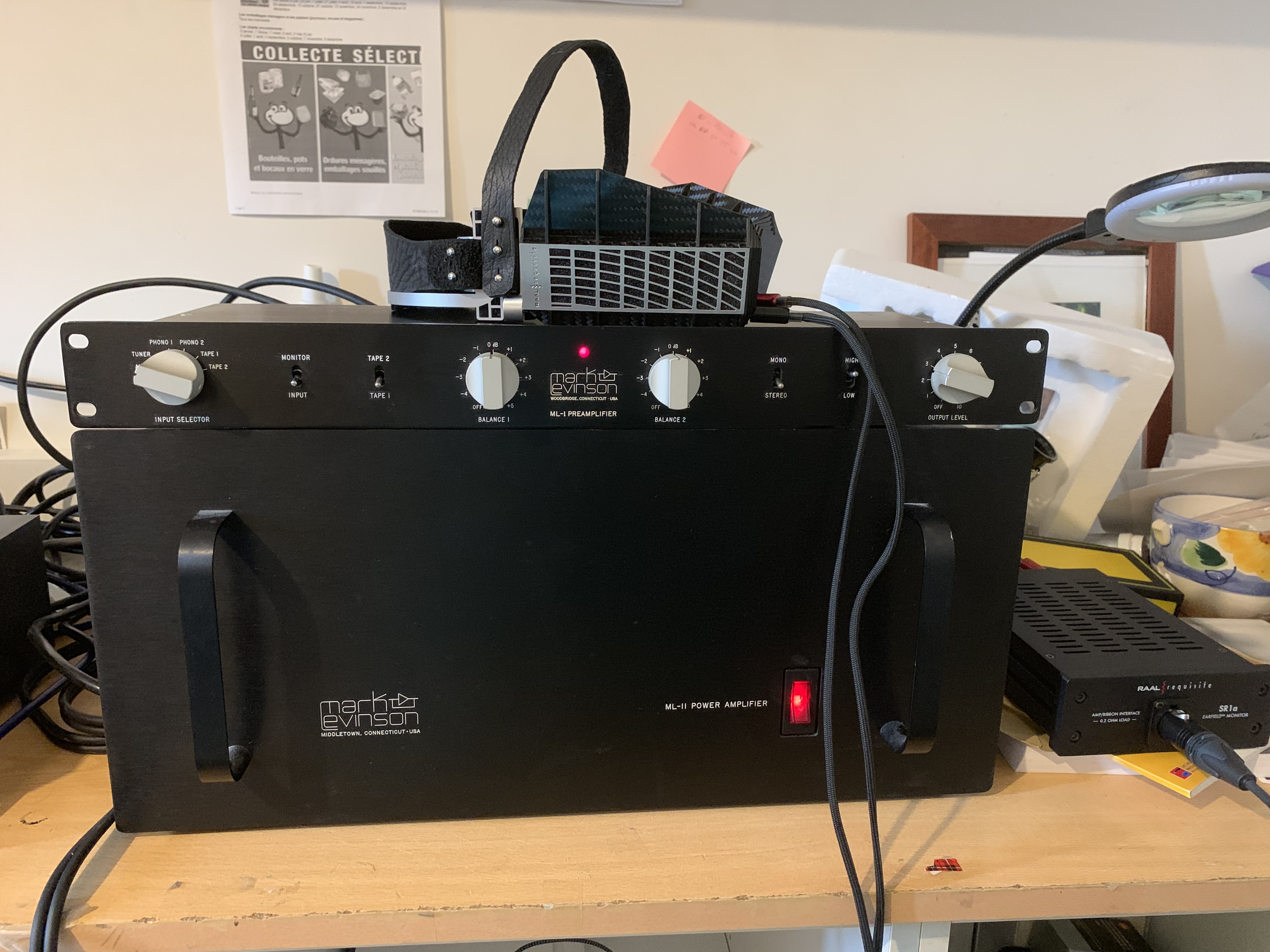

Hi all, in your opinion what would be the best solution between the Schitt Ragnarok 2 and 2 Schitt Vidar mono to drive the SR1a?
I received one for 2 weeks 2 days ago. I tried it on a combo Mark Levinson ML1 preamplifier and ML11 amplifier but I am afraid the amplifier is not enough powerful (50W X 2/8ohms). I don’t want to spend more money in an amplifier for the moment. Thanks for your help.
