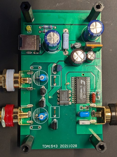

I got my TDA1543 "47 Labs" clone. Wow - tons of palpability, yet not lacking in bass or detail. At first blush, it seems better at imaging than soundstaging, but I barely have an hour on it.

It should be amazing. Even more so considering the price and the age of the design. Only thing holding it back are the output caps (filter) and the input is limited to 48k. This makes a big difference in air and soundscape. That little budget chip made by our Dutch engineers was way ahead of its time. And unfortunately, like always, the marketing managers managed to cripple and mame anything good from Philips electronics audio. Imagine my first Philips CD would have sounded like this in 1987... I would probably not have held on to vinyl. Glad I did though.

I am in utter disbelief over how good it sounds. Regardless of the fact that it was only $30 (not counting DDC, cabling, and linear psu).
To your point, there is someone selling a version with upgraded caps for about $60 - I should have gone for that one. I know you say that soldering caps should be easy, but I don't have the guts to try...
@sajunky and @]eep, would you recommend me flipping the circuit board over and soldering a piece of wire to bypass the capacitor? I could probably do that.
If you recommend keeping a capacitor in the circuit, which one do recommend? I could then find a cell phone repair store to do the work.

Do you know how to use a multi-meter, toots?
STOCK UNIT:
In "Volts", measure the voltage across each jack (L, R). Plus (+) and ground (-) . It should be very low (mV).
SHORT CAPACITOR:
Measure again ... voltage across each jack (L, R). Plus (+) and ground (-) . If it is still low, then you can safely use with shorted cap. IF NOT (> 1vdc), upgrade to higher quality cap of same value (or similar value). I use Sprague 10uF film in these circumstances.

Well, normally every amp has input caps right after the input jacks (and often these are the same crappy quality like one with the new Infinion Merus I just modified). The only problem could be that you get a few V over an analog potmeter (causes crackling when turning) but nothing too bad (I haven't noticed any concerning wear).
So yes, bypass them. Just a wire.
While Sprague sounds good (I love the Sprague paper in oil) they will be huge in 10uF. And the gains compared to the next caps the signal will pass (probably something like Vishay 10uF MKT or MKP, small green or blue blocks) will be lost. So wasted effort. Where as when you take them out... sonically there is no better cap than no cap. And no cap=no $. Recapping (pun intended), expensive caps are a waste of money to buy a sense of security.
