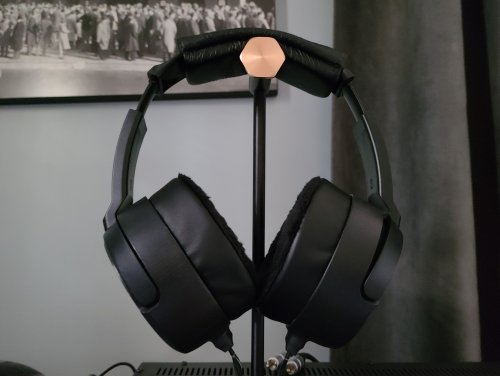

So I recently bit the bullet after seeing a deal on Nectar Pollenator headphones that I could not resist. The current price for regular Pollenators is $350 - but a special "brighter" pair was offered on EBAY for $215 shipped. After discussing with the creator, Sajeev - I found that these were either accidentally or experimentally tensioned differently so that the bass rolls off a bit more, but they also have more treble energy as well. Below is the chart I was given for my pair. Keep in mind that my review will be based on the "bright" Pollenator, and the regular one might sound a bit different. Mine prior to modifications (see below) roll off at 60 hz, where the regular ones on the Nectar site stay flat down to 20 Hz.
I knew before I received my pair - that my big head and ears could be a problem with Pollenators. My wife has frequently complained that my big head prevents her from buying me fun hats. That said, with the stock headband and pads - I could comfortably listen at the biggest extension setting. That said the stock pads are TERRIBLE. They can't seal because the surface they sit on is uneven, and they connect with 3 pieces of velcro. The stock pads are "snake skin" similar to the Stock Sony MDR V6 pads, and worse than the stock Koss ESP950. They don't seal on the outer diameter either because the fit is not snug enough. The sound was not pleasant in my opinion - it was not clear, and with strong bass I got weird vibrations which I believe came from the surrounding housing?
What makes pad rolling with these a little difficult is that pads sit in a recess maybe 0.375 inch deep as shown below. So pads larger then 95 mm will only fit by forcing them. I also don't think that sitting pads directly on the stators is a good idea - so I used 3mm craft foam as shown to make a consistent rim around the edge. On other stats, I've created noise when my ears touch the stators through the pad mesh. This ring of foam prevents that. I found pads I already owned that were slightly oval - that I could force in, and the sound immediately improved - but between the now high clamp force and a hot spot on the top of my head I couldn't listen for more than a half hour due to discomfort. At that point, I thought I may have wasted my money. Thankfully I decided to try two other sets of pads which worked.
From Amazon, for $16 dollars I found 95mm pads with a 47mm Opening, cheap pleather but soft memory foam and soft velour interior. I normally don't like velour pads - but these were comfortable - I don't mind my ears touching the edge on the inside. These are 30mm thick versus the 20mm stock pads. Because of the softness, clamp is totally tolerable - I've listened for up to 3 hours at a time. The fit against the sides is snug even without adhesive, and the bass is MUCH stronger than with the original pads, which I believe were used for the measurements above.
Then through shear luck - I noticed that the pads of my Plantronics Backbeat Pro Gen 1's are the same diameter at 95mm. They're solid pleather, and 20mm thick so that the inner opening is 55mm - less contact for my big ears. I pulled them off and used the plastic ring to press into the Pollenators with a tight fit. To be honest, it's TOO tight so I'm going to use laser cut circles and speaker cloth to replace the rings long term, the outer diameter will be a couple mm's smaller than on the Backbeat Pro. The picture of this setup is below, and these are the pads I used for the comparative reviews with my Koss ESP95X and Kaldas RR1 Conquest.
The overall build quality is not great - they're obviously 3D printed and there's occasional imperfections visible in terms of surface texture and paint coverage. I don't mind that when I consider the great, and for stats, somewhat unique sound quality. That said - what bugs me is the complete lack of dust protection. Both my Koss ESP95X and Kaldas RR1's used to whine due to dust before I repaired them. I've found that speaker cloth on rings works well to provide decent dust protection, so I'm waiting for 3D printed rings to arrive so that I can put dust protection over the outside stators. Nectar provides foam plugs to protect the drivers when you're not listening, but if like me you're listening for hours at a time, that's not a reasonable protection strategy in my opinion. If it happens, the electrostatic whine is intolerable. I'll report back if my dust protection works - and if it's sonically transparent.
I'll provide a more detailed comparison to my other stats in a follow up post, but my initial review will be that these are the first Stats I've heard that sound like Planars. The notes are THICK and FULL, and my initial listening had me reminded of my Monoprice M1060C's. But with excellent stat speed, and no distortion. I sold my Stax L300's and kept my Koss ESP95X because the Koss had thicker notes - these are thicker yet. I was worried that it may mean a loss of microdetail but my eventual comparisons would prove that is not the case.
These stats are very mid forward, and have a very small soundstage. Earlier in my audiophile journey that would have been ideal for me, I only wanted to hear from the front row if not closer. Ever wanted to hear the voices of Brandi Carlile or Florence of Florence and the Machine more clearly? Then these are for you. My listening volume was limited by how much mids my ears could take. That said - the bass extends deep. I use an admittedly inaccurate tone test to figure out how deep my headphones go. I listen for a couple hours to make sure I'm listening at a reasonable volume. Then I pull up a tone generator at that volume to see how deep and high I can hear. I still hear reasonable bass at 20Hz, practically identical to my Kaldas RR1's. On the Koss ESP95X that reasonable value is 30Hz regardless of pads. The high end for the Pollenators maxes out my 42 year old ears at about 15.5 Khz.

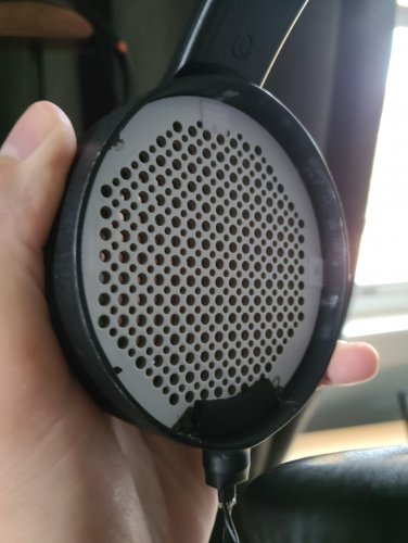

So this weekend I got in 3D printed rings to try and create dust protection for the outside stators of the Pollenators. On the ID, I'm currently relying on the mesh of the pads I use. That may change if I get paranoid enough. The result is in the pictures below. In essence, I'm relying on speaker cloth to provide dust protection when I'm listening. I've used speaker cloth on my Koss ESP95X's and Koss ESP6 to good effect. My Koss ESP6 project has been sitting on my desk 24/7 and I've yet to have dust penetrate . . . For the Nectars, I'll keep them in a case when I'm not using them.
Here are the steps:
1) Create a 3D printed ring, mine was made out of nylon with a 6.5cm inner diameter, 7.5cm inner diameter.
2) Glue the ring to speaker cloth, stretching it as needed. Let it dry depending on the glue you're using. I've used elmers before, this time I used super glue.
3) Use a compass cutter to closely match the ring to double sided tape - or in my case, Sewell Micro Suction tape. The Micro Suction tape would be permanently attached to the cloth side, and would use micro suction to connect to the headphones. This is the hardest part, just to make sure the tape doesn't block the center, and also doesn't show around the outer diameter. It's still pretty easy.
I've been using micro suction tape to replace adhesive on headphone pads lately. It creates a very solid seal. If dust ever gets through these screens I can just pop the screens off and reattach them. Supposedly if the tape gets dirty you can just wipe it off with a damp cloth. I've only listened to these for about 3 hours - but I'm convinced the solution is sonically transparent. I've blown dust off the surface, so I'm convinced it's blocking some dust - hopefully all of the damaging stuff. I'm very pleased with the finished look - though I'll have to touch up a couple spots where the glue showed.
Another thing I tried this weekend was using the Koss E90 energizer. I created a Stax-To-Koss adapter by using the extension cable, a Stax female adapter, and a 4M7 resistor to prevent arcing. I'm terrible at soldering and it was very easy.
Overall it works, and would allow a Koss ESP950 owner or ESP95X owner to "cheaply" try a very different electrostat sound. Even using the E90, the Pollenators have much more and deeper bass. The sound is much more mid forward and concrete. Not ethereal or "easy listening".
With the E90 - compared to my SRM 717 - the bass is muddier, and highs are sharper with the Nectars. There's even less soundstage. Would I use the E90 as my only amp with the Pollenator's, no. Would I use it as a backup or secondary amp at work? Yes. A Koss owner would get an inexpensive intro to other stats, but would probably eventually want to upgrade.

So my latest modification of these headphones involved making a baffle to allow larger pads. I don't own a 3D printer, but I drew up what I wanted and had it printed by Jawstec at Craftcloud. The pair of baffles cost me $22 for a pair printed out of black, bead blasted nylon. I bought $20 100mm lambskin angled pads and stretched them over my baffles. I added a rubber band for tight fit, to the "pilot" in my baffle. Then the pads and baffles simply slide into the nectar opening. They can be swapped in seconds. The fit is firm enough that you can't rotate the pads once in, and I get a solid seal.
This increases the soundstage by recessing the mids slightly. I think most people will prefer the Pollenators this way. The soundstage is better, more logical - and easier to place the instruments. I see myself occasionally wanting to swap pads for the more intimate soundstage of the Plantronics pads. Below are the pictures of the pads. Contact me if you want the 100mm baffle STL file, but if you want a modification to allow for larger pads like the Eikon pads in the first post - contact me. I'd be happy to modify the original file, though I'll guess at the logical largest diameter to use.
The fit is tighter than before, not as comfortable. If I get bored again, I may print headband adapters so I can use a more comfortable hifiman headband. I have to say, overall I love these headphones. I now have a collection of 5 electrostats, and if I could only keep 2 it would be the Stax L700 and these Pollenators. Not because the Pollenators are better than the other 3, but because they complement the Stax so well - and are so tunable via pad changes.
