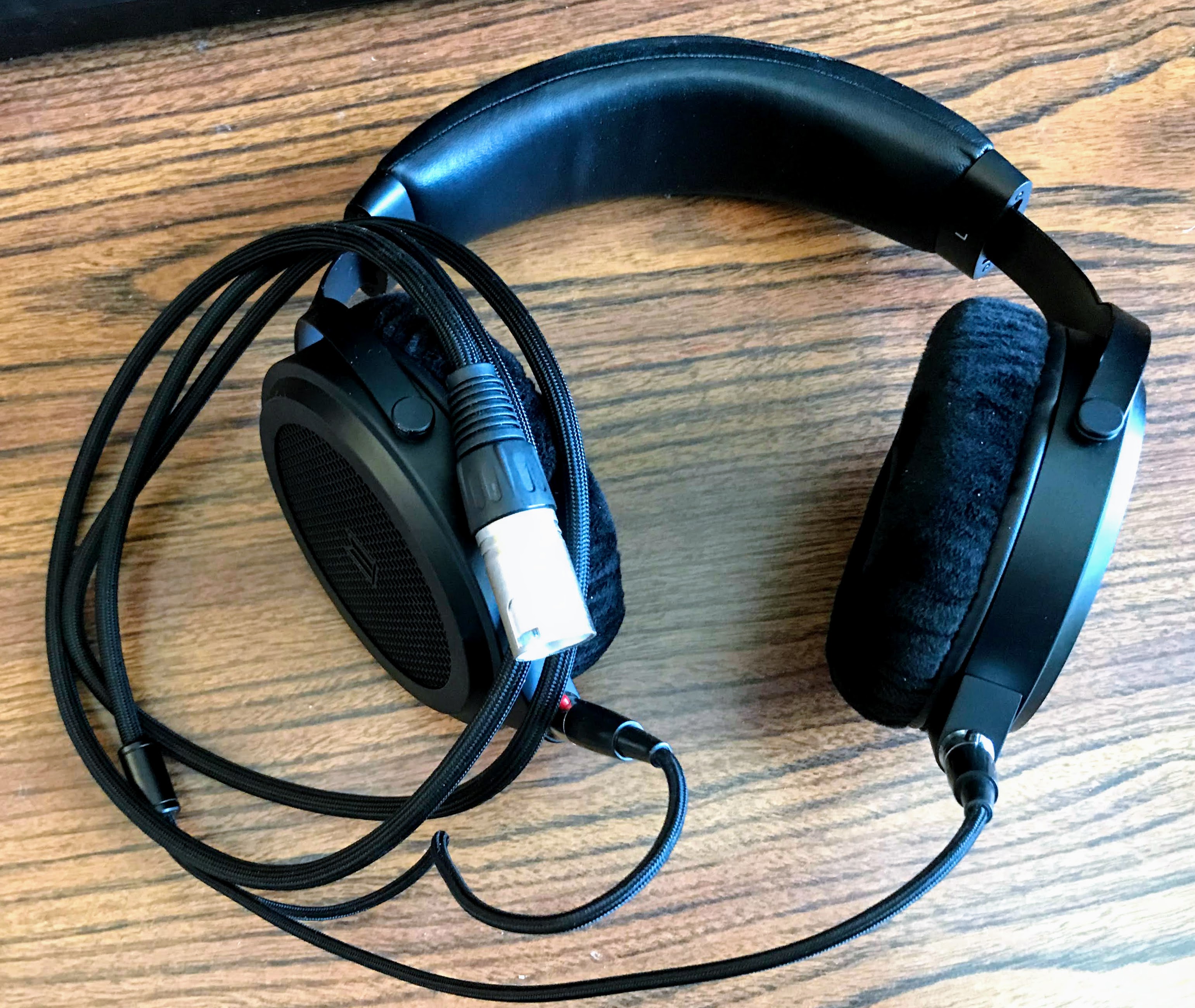

I took apart the stock cable and it is the best built cable I have ever seen. They actually filled the 1/4 in connector with some glue material that made it rock solid. I have never seen such a solid cable. I felt bad cutting off the 1/4 connector when so much good craftsmanship had gone into it.
I went to this website to learn about the pin-outs that Monoprice used: http://www.zadiustech.com/monoprice-m1570-balanced-cable-guide/ Using the diagrams and pictures, I was able to cut off the 1/4 and put a balanced XLR on it. There were four Litz wires inside, so no problems making it balanced. If you don't feel comfortable working with Litz wires, don't do it.

Monoprice Monolith M1570 headphone wiring on my set;
Left channel
+Blue
-Copper
Right channel
+Red
-Green
I warn you again, don't do it if you don't feel comfortable working with Litz wires.
