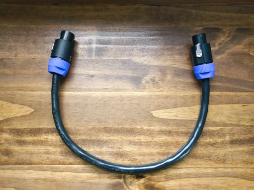

Been moving pretty slow today on phono progress, had to run some errands, but worked out the umbilical wiring.
Here is the Belden 1039A I am using, four individually shielded 16AWG twisted pairs, with another overall shield. Two pairs for the DC heater regulators, one pair for the B+ / PS ground, one pair for redundant chassis ground which the shields are tied to at one end. This cable is no joke, need superhuman strength just to remove the jacket.
Here is the finished umbilical with Neutrik NL8FC connectors.
Wire is pretty rigid but it can be worked to lay the way you want it. After some (American) football, I will put together the power supply :)
Oct 11, 2020 at 5:29 PM Post #807 of 6,987

Oct 11, 2020 at 5:50 PM Post #809 of 6,987
ROFL!! That reminds me of a Kimber speaker cable I saw at CES many moons ago. Black Pearl, I think? One 8' piece (one channel) weighed in at around 50 lbs, and the retail price on the pair was around $15k (USD). I'm not one of those "a cable is a cable" kind of people, but even I have limits. :grinning: :grinning:
Oct 11, 2020 at 6:26 PM Post #810 of 6,987
Tuff wire to work with I use it at work to feed power and signals to sensors. High power frequency drives with a 480 volt 50amp square wave to a motor puts out plenty of noise.
No noise pickup with 1039A double shielded cable.
