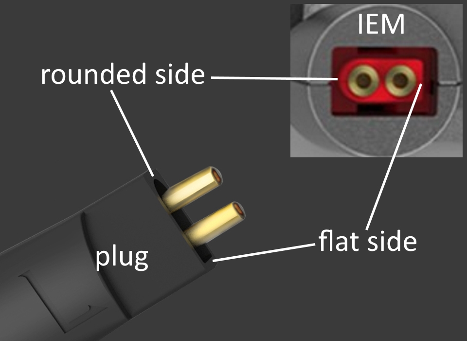

This is an all too common issue with the KZ 2-pin models, and is usually caused by accidentally plugging in the cable backwards.
The stock KZ plug will technically "fit" when plugged in backwards, but the only thing holding it in is the friction of the pins (allowing it to separate & fall apart at any time). Plugging one side in backwards will also cause that side to be out of phase.
When both plugs are oriented properly and seated fully, there’s a tight mechanical fitment due to the plug's shape - curved on one end and flat on the other. It’s designed to fit like a key in a lock.
Update: This guide only refers to KZ Paragraph A and Paragraph B. The new Paragraph C is not keyed with a flat end. It's symmetrically rounded on both ends. Although be aware that Paragraph C can still be plugged in backwards!!
Anyways, I've included the below photo so people can double check their Paragraph A and B connections to make sure they're correctly oriented:
Note that only the stock KZ cables have the rounded/flat keyed plug. Non-KZ 2-pin 0.75mm cables will fit KZ models (TRN, BQEYZ, CCA, Kinboofi, NiceHCK, HiFiHear, etc). However, the plugs on those cables are flat on both sides so it’s wont be obvious. You’ll need to verify the proper orientation using a multimeter to identify which pin is ground, so you know which way to plug them into a KZ IEM. On KZ IEMs, the FLAT side is ground, and the rounded side is +. Some aftermarket cables do have a red dot on the 2-pin plug, which indicates that pin is +. If you have a non-KZ cable and are confused or unsure of the proper orientation, ask 1st before plugging it in to prevent possible damage to the IEM.
