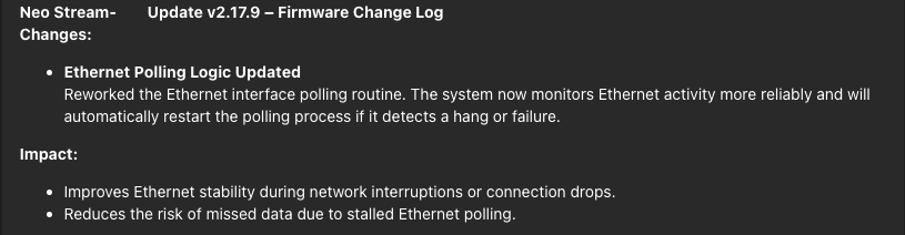

Apr 30, 2025 at 11:46 AM Post #1,524 of 1,526
Hey folks, just an update, new firmware is available for the NEO Stream... > V2.17.9
As always please allow 5-10 minutes for the update to complete, depending on your setup
Cheers!!
