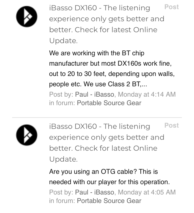

iBasso have said they are looking into it, and have been responding:
4B7E435E-57D2-4A2D-8A27-E01DE56986DF.jpeg 99034540-369D-4126-85B8-D8E4FA93151A.jpeg 6EF3F863-E2DA-450B-B74E-0361B2E142F0.jpeg 38B28453-D2CB-425A-BFF4-CFEDD2D6DFA6.jpeg 6FA65CE6-FAD6-480E-B565-823190EBB456.jpeg 3A7C1531-2B4B-42F8-B0CB-24A571DB4BBB.jpeg
iBasso (and DX160 users) probably wants this sorted as soon as possible - and no doubt will report back on the BT and Wifi questions/issues when they have identified what is the issue, or not. And have something concrete to present after their testing.
Head-fiers who have been on the other iBasso threads knows iBasso looks after their customers and do their best to attend to any issues asap.
BT - Not sure what is happening there. I have not done extensive tests myself. Leaving that up to iBasso.
Wifi - no doubt they are testing this also. I could find no issue with my device.
Hissing/waterfall sound. Reports indict the usual suspects: sensitive IEMs. (But typically not with some other not as sensitive IEMs/headphones).
*Even though Overall the DX160 has quite a low floor noise.
Anyway. I guess for now we wait until the tests are done by the engineers and then get a report.

It's all good and well quoting these Ibasso we are looking into it quotes but when they say we haven't experienced the WiFi issue and we use class 2 Bluetooth and it should work just less distance really isn't the answer...
Or have you tried a braided cable...
Although they state we are working with BT manufacturers.
Well let's have an update then??
Truth is that whilst some Dx160 may work there are now regular occurrence of one's exhibiting issues.

We continue to look into the issue some are having with BT. I don't have much to add. I would suggest that if BT is a primary or needed function, that the DX160 may not be a dap for you at this time.
We have worked with the manufacture of the BT/Wifi chip and have used this same chip for some time without issue. But right now, we still have no resolution. We very recently got back two units that had the BT issue. We tested them hoping to find out the issue but they worked without a problem. Waling around, distance all worked! Good? Not really because we want to know the issue and these work so we will continue to work on this. Also the Antenna is custom made for the DX160 by a company we have used in the past. It is made for 2.4GHz and 5GHz and made to work in the environment of the DX160 case. The best BT I have tested is the iPhone 11 Pro. It was a phone suggested by a user here and so I got one just to test and Apple knows how to do it but they have the R&D to make sure the chip manufacture does it right for them and can make custom chips. I am making no excuses and we continue to try to find out what is going on but if BT is the major and needed feature you need, I suggest for right now for the DX160, you listen to one first to make sure the BT fits your needs as many people have no issue and some do. For all other functions, I don't think the DX160 has any rivals at the price point.
