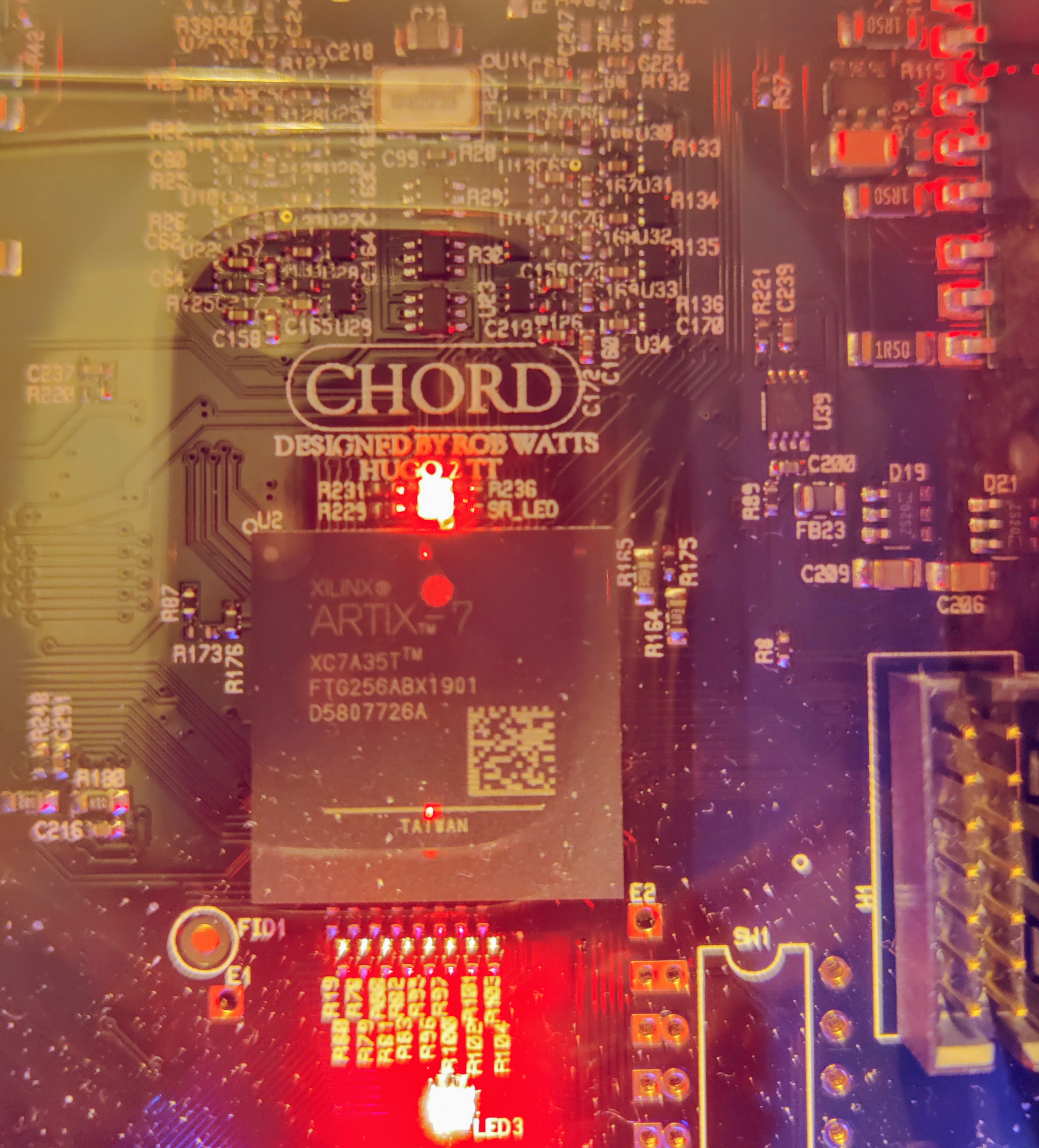

Looking at this almost every evening when I put my Meze Elites on, makes me proud that I was able to purchase a TT2 second-hand with a bit of a stretch to my wallet. Because it sounds so good to me (lifelike, balanced, satisfying, spacious with excellent imaging). Yes, the Dave is even better, at least in transparency with a sharper image and more details, but that is clearly out of reach to me even second-hand. At least for now.What are they going to accuse me of next?
As a designer you should be and I know you are even prouder. I do not envy you though when you have to judge what conversations you should enter to educate/save reputation and what conversations you should simply ignore. Good luck with that!
