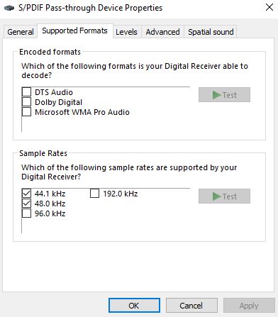

You could try disabling undesirable frequencies in the ‘supported formats ‘ tab
Hmm. I asked the same query. What if the files are 96, 192 kHz ones ?Yes, I have this. But does it mean that the Advanced tab limits everything to 44.1k?

The TT2 doesn’t default to anything, it just plays the sampling rate it is given. Clarifying in case someone thinks they can adjust this on the TT2.You could try disabling undesirable frequencies in the ‘supported formats ‘ tab.

Moon Audio’s walk through for setting up the Hugo/Hugo 2 mentions disabling the sample rates in the supported format tab and just setting the highest supported rate in the advanced Tab.Yes, I have this. But does it mean that the Advanced tab limits everything to 44.1k?

Managed to solve the windows 44.1 in TT2 issue, by unchecking all supported rates in the sound properties and maxing out to 24Bit/192 kHz in the advanced tab.
