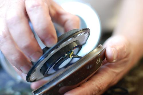

1. First you’ll want to remove the pads on the cans. To do this push down on the pads and rotate counter-clockwise until they come off.
2. After removing the pads you will see four screws that secure the frame to the driver. Remove these.
3. The cup and driver should now be able to come free of the frame without much resistance. Make sure you don’t jerk the cup and driver assembly as the cable is still attached.
4. You should now be able to see four screws that secure the driver to the cup. Remove them and gently lift the driver off of the cup.
5. Take the D7000 cups and inspect them. You should see four screw holes and a notch just above the bottom of the cup (illustrated in the accompanying picture).  Drill to a depth that is roughly 2 centimeters up from the notch (just a little bit down from the top of the yellow oval) so the posts on the D2000 will fit these cups. (Sorry about the poor picture quality on this one; my camera didn't want to focus)
[size=medium][/size]
[size=12.0pt]NOTE: If you drill too deep on this step (like I did) there are a couple ways of fixing your error. One is to purchase longer screws and the other is to fill the holes you drilled with wood putty and use the stock screws.[/size]
6. Taking your drill and 5/8” bit, center it on the screw holes and drill straight down. If you are worried about depth stop periodically to check. The finished product should look like this.
7. Fitting the cups on the driver housing. This step is possibly the most difficult of the entire process. When I did this the fit was very snug and required some maneuvering to accomplish. I recommend pinpointing the hole that is the closest to the outer rim of the cup and beginning fitting with the hole across from it. NOTE: Make sure to wipe off any loose wood particles before fitting.
8. Follow these instructions in reverse using the stock (or longer) screws for the driver housing and cup attachment.
9. Sit back, Relax, and Enjoy!

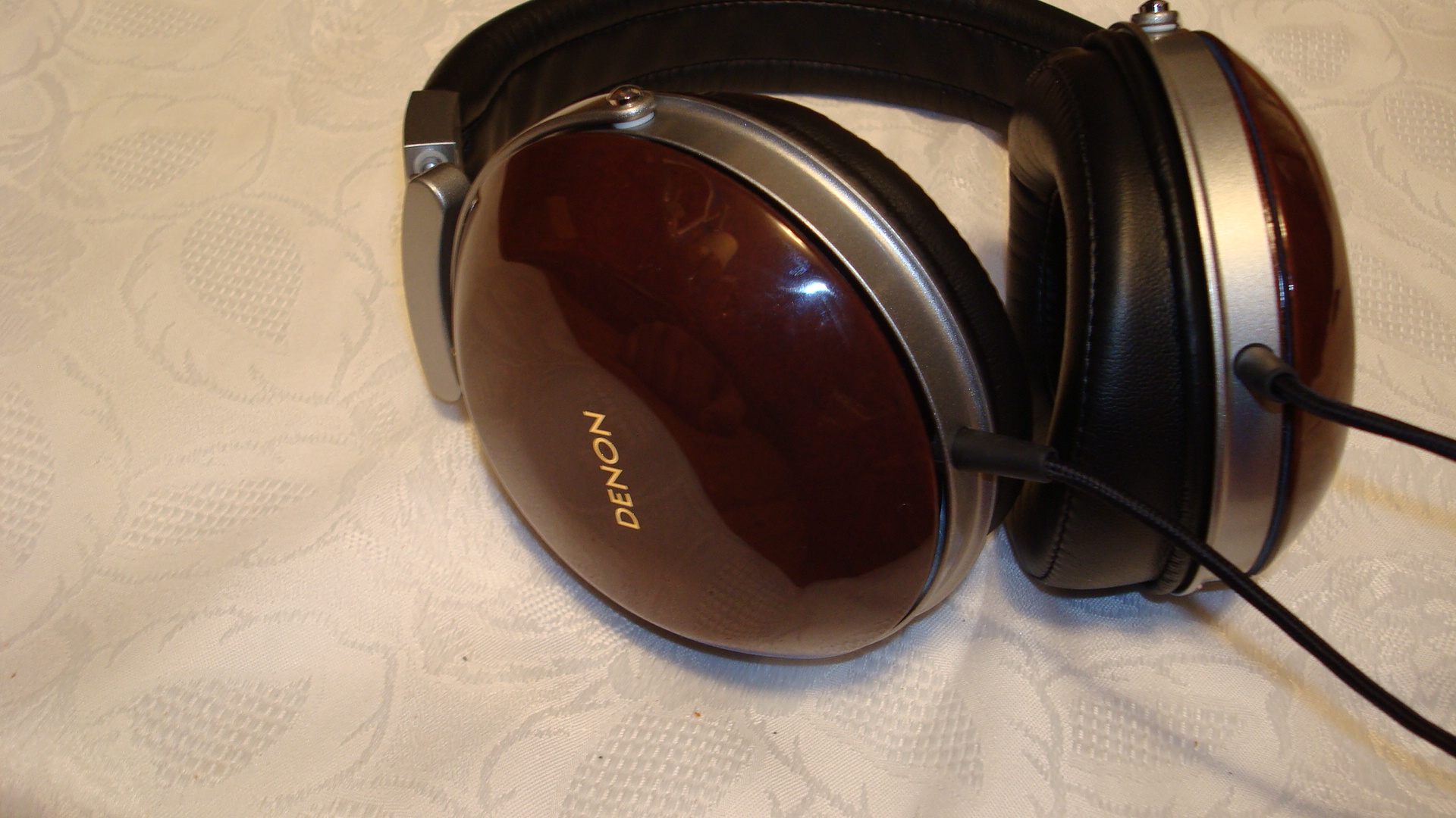

Initial Impressions:
As you can see from the pictures I opted for the D7000 cups with MarkL mod so I can't say what the effects of each are on the sound. Anyway my impressions.
The bass is tighter. Mids are a bit more present. When switching back to stock cups the D2000 sounds somewhat hollow.
All in all, the sound seems more natural. The highs are smoother and not as sharp (still pretty crisp, a little sparkle on top I guess). Seems to have better separation and details are more noticeable. I may be imagining this but I also notice somewhat of an increase in soundstage size. Again, I'm not sure if it's mainly the result of the cups or the half MarkL mod performed on them but either way they sound incredible. The character of the D2000 isn't lost so much as refined in all aspects which was quite a shock at first. These are definitely keepers.
[size=12.0pt]Honestly the changes are simply outstanding from my view.[/size]
[size=12.0pt]If you have any questions about this mod feel free to pm me. Also if you feel there need to be more pictures explaining accompanying the first few steps let me know and I'll add them.[/size]

NapalmK and I did our mods on the same night, but went about it in two different ways. I will pick up where our methods change. I'd like to thank ULTRA-HARMONICS for showing me and many others this method in this thread. To my knowledge, he figured out this way. Napalm and I are just messengers making it a bit more clear for those more hesitant to do the mod without knowing exactly what is involved.
Quick disclaimer: The method I used DOES void your warranty (I would presume). Instead of cutting the wood cups of the D7000, I cut the posts off the D2000 driver. Why would I do it then? Two reasons: Easier to manage than cutting into the cup and no need for different sized screws.
However, the D2000 cups fit back onto your driver after my version of the mod as well. As in, this can also be reversed! There will not be as much support for the D2000 cups but it will still hold up just fine. As I say later on, the support for the D7000 cups is not an issue, as it has extra wood around the screws directly on the cup instead of the driver. The D7000 cups will be very sturdy.
What you need for this version of the mod:
Micro Screw Driver
Dremel/Jeweler's Saw
D2000s
D7000 wood cups
That's it! You can reuse the same screws in the D2000s and it will fit fine.
I'll pick up with unscrewing the shell and driver from the cup:
Make sure you keep track of all of your screws as they will be reused.
Now, instead of cutting into your cups, use your dremel or Jeweler's saw to cut off the posts. I realize most don't have a Jeweler's saw as I used, but a dremel will be just as easy. Just make sure to be careful not to cut the cable, but it is easily avoidable.
You can throw these posts away after you are done with them. They can't be used for anything else. After all four posts are off, line up the D7000 cups with the driver. Make sure that DENON is facing upright whenever you line it up. It should fit perfectly, no problems.
Screw it all back together and you are halfway done! The same screws that you used for the D2000s can be reused for the D7000s here. Since you didn't cut off the inside bulges in the cups, there is plenty of support for the cups. Finish the other side and you are done! Enjoy the sound and aesthetics!
Ignore the plastic around the adjusters on the band. I'm just weird and haven't taken them off yet. Keeping it nice and sparkly I guess heh. They did come in use though, on the D7000 headphones, the left/right markings are on the band, not the cups like the D2000s. Make sure you find some way to keep straight which side of the headphone is left and which is right. For the moment I have a big L written on the left ear side plastic part.
Impressions: Keep in mind that my D7000 cups were also dampened with dynamat by Markl, so you might have slightly different results than me. I honestly didn't expect much difference when I put on the wood cups. I have been pleasantly surprised with the changes I've heard. To be honest, there has not been much change for me in treble, mids or soundstage, but the bass is much more  textured and clear. Possibly punchier? The difference might be not having the cotton in as the D2000s had in. Anyway, the first song that really took me by surprise was "Are You In?" By Incubus. Once the bass guitar enters the song I had to do a double take when I heard the bass guitar more as an instrument than as just a feeling or frequency. I don't want to blow the changes out of proportion, and I still have more listening to do, but I felt like I should mention that there are more differences than just looks for these cups.
