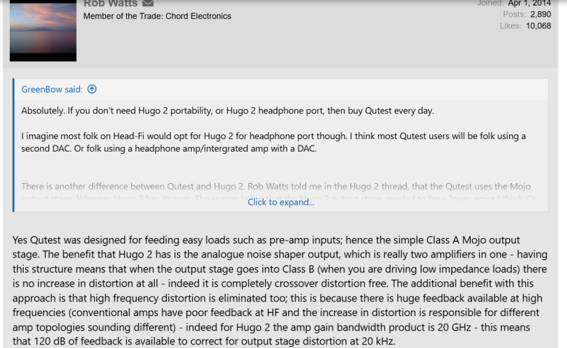

So you drove your headphones from the RCA analog outputs? I did not find any information about the output impedance (on the product pages) so how do you know it is "very low"? Is it below 1 ohm? 10 ohm? 100 ohm? Typical output impedance for RCA outputs is 100-1000 ohm. Also, are you sure the voltage level selection doesn't change the output impedance? It is possible the DAC uses 3Vrms output all the time, but resistors (voltage dividers) are used to select output voltage level meaning the impedance changes.
Jul 26, 2022 at 9:31 AM Post #7 of 49
All good points.
Yes, I drove my headphones directly from the RCA analog outputs of the Chord Qutest, as has been tried and reported on by many people on the Qutest thread here.
Many online listings state the output impedance to be 0.025Ω, such as this one:
https://www.moon-audio.com/chord-qutest-dac.html
It appears to be a spec that used to be on the official website/manual, but was deleted for some reason.
More concretely, this review measures it to be 0.4Ω at 3V:
https://www.stereophile.com/content/chord-electronics-qutest-da-processor-measurements
As for the voltage level selection, the designer (Rob Watts) has stated on the Qutest thread here on head-fi that it is done digitally in his FPGA.

Doesn't tell much. Someone should measure the output impedance when the maximum output level is set to 1 and 2 volts.
In this arrangement the 3 V output impedance is less than 1 Ω, but for 1 and 2 volts the output impedance is about 2R/3 meaning if R = 120 Ω, the output impedance is about 80 Ω.
I understand, but, going back my initial two test-cases: in both the cases, where max voltage is set to 1V and 3V resp., I have now learnt that the output voltage is 1V, since in the 3V case I'm digitally attenuating the signal by the calculated amount to drop the output voltage to 1V.
As a result, even if the output impedance at 1V is indeed 80Ω, that wouldn't explain any differences I'm hearing between the two cases, or so it seems to me. Or am I misunderstanding?

We don't know what the impedance is at 1 and 2 volts settings, but if the device is constructed in a way I am suggesting, it may have huge effect on sound! 80 Ω is a lot for driving headphones, especially low impedance headphones like 32 Ω. Especially open headphones need typically very low amp output impedance for electronic damping. So, the sound might be less controlled and more distorted with 80 Ω output impedance compared to less than 1 Ω impedance.
Jul 26, 2022 at 1:58 PM Post #12 of 49
I understand this. All I'm saying is that whatever detrimental effect the higher output impedance has, it should apply to both cases, since in both cases the effective output voltage is 1V, and therefore should not contribute to hearing differences between the two cases.

This appears to be your misunderstanding. It won’t necessarily “apply to both cases”! It could depend on how you get to that 1V output voltage. For example, driving a 3V output stage with a digitally attenuated signal (to achieve 1V) or driving a 1V output stage with less or no digital attenuation. In the 2nd example, the analogue circuitry reducing the output to 1V could also be significantly raising the impedance, circuitry that isn’t in the 3V output stage. Therefore this significantly higher impedance does not “apply in both cases”, it would only apply in the 2nd case and could make an audible difference with HPs requiring a lower impedance.
This is what @71 dB was trying to explain.
