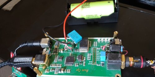

Aug 2, 2019 at 11:23 AM Post #1,184 of 1,706
Maybe you wrote it before but about what modded Xmos spdif converter and lifepo4 battery are you talking here?
I didn't want to get too off topic. It's one of these converters. $45. What makes them a great value is that you can use an external power supply and the on-board regulators are high quality LT1763, unlike the Singxer F1 etc where you can't avoid the noisy regulators. So you desolder the clocks, add whatever new ones you want. Get a A26650 Lifepo4, a battery case, and a switch. Just wire up the battery to VCC/power pin of the clock(s) and ground, bypass with a .1uf cap and that's it. Crysteks are nice and big and easy to work with. I've used lifepo4s on other dac projects and you always get a level of sound quality that is hard to match. In this case with the converter what you get is sonic purity.
Aug 2, 2019 at 12:39 PM Post #1,185 of 1,706
This seems to be an interesting project! Do you have any suggestion about the connector for the I2S out of this converter?
