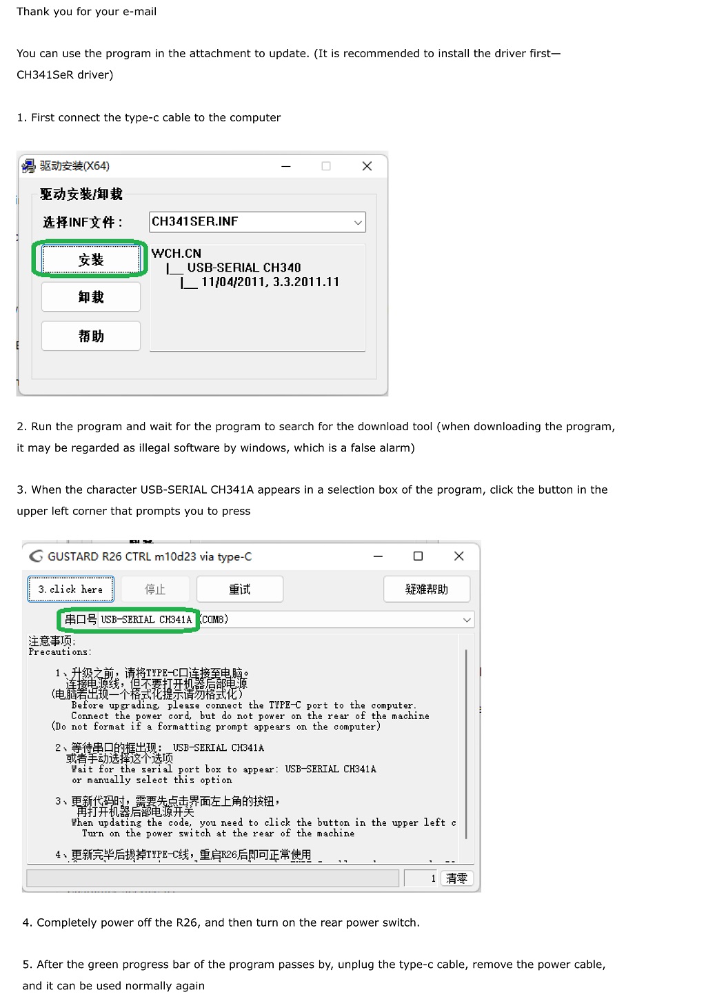

Hello All, I also wrote an email to Gustard to give me a solution for the problem with the high pitch noise (I experience that if the R26 is set to Fast Filter - the noise was the
most annoying and louder than with set to Low or Mid). The file i formerly found in this forum was not complete i think. here are the needed files for update.
it try it today and it works for my unit - the high pitch noise is definetely gone and only a little buzz can be heard if your ear is very close to the Display.
Thanks a lot for your help :)
I managed to do the update and everything went fine an the high pitch is completely gone 🤩
But to the clear… what was that for an update? Was that an update for the dac part of the R26? I only did an update of the Renderer and don’t find anything else on the Gustard website?
