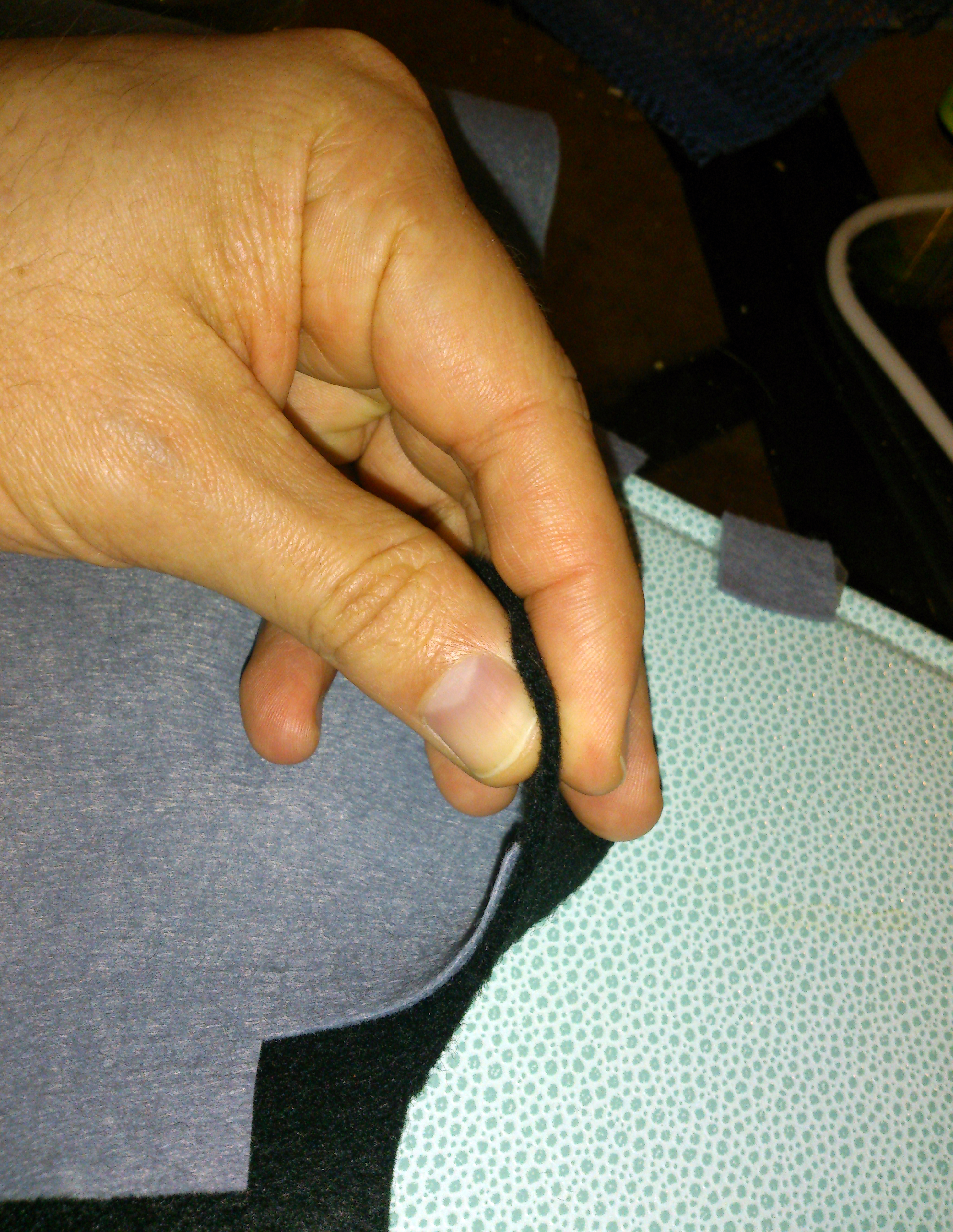

4) Now you have to cut the felt into the proper shape. For mine I used the circular felt pads from Super Sliders and trimmed 1/4" off the diameter of the pads. I thin cut the pads in half. Once cut in half I cut a half circle out of each of them, also making sure that the remaining ring is 1/2" wide.
5) You can now remove the adhesive backing off the pads and adhere them to the inside of the headphone. It's perfectly fine if the felt is a bit off center, just as long as you leave enough room to escape from the driver and cup.
