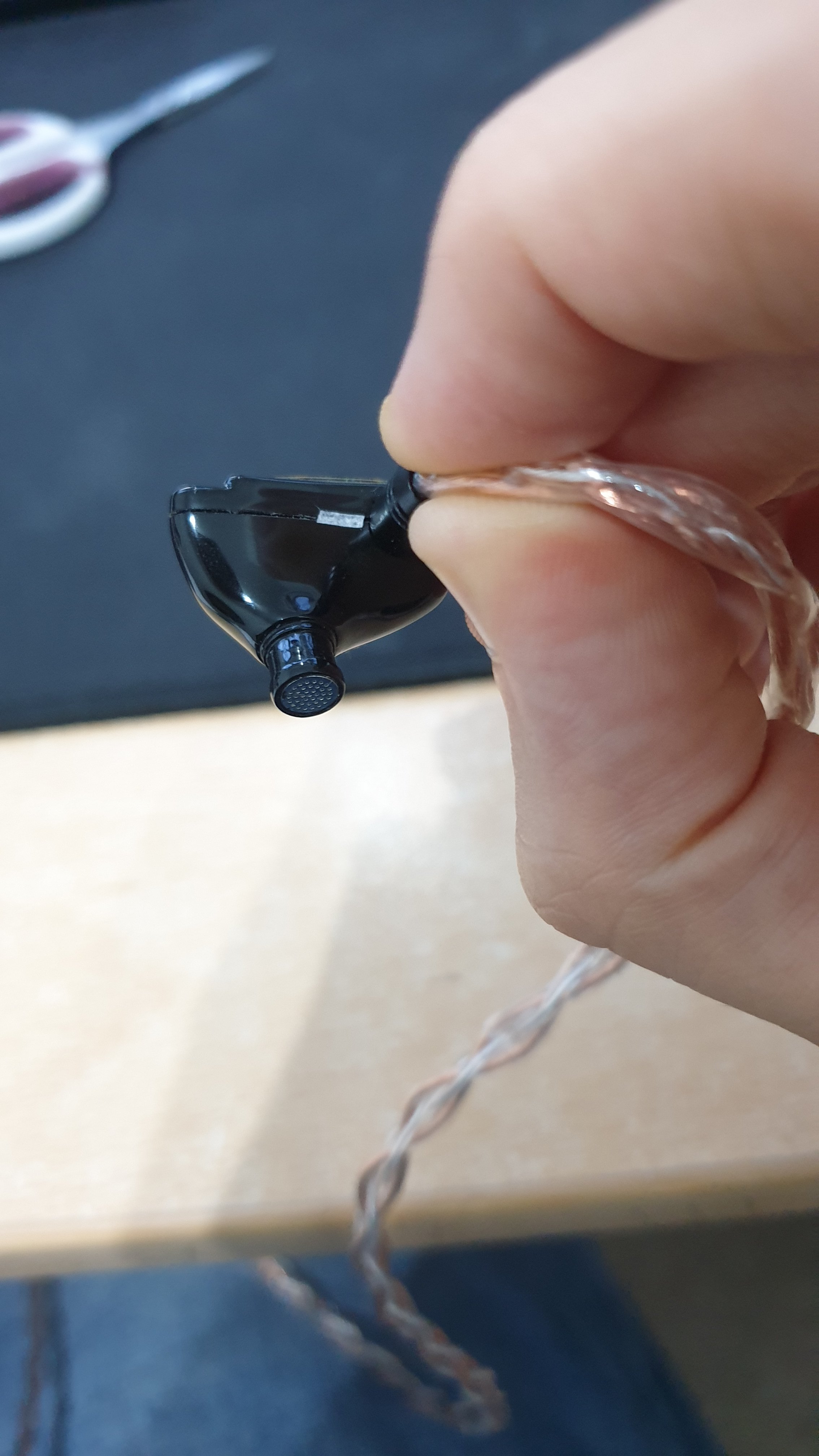

Thank you for sharing! I see two holes - just to be sure, are you referring to this one:
Or this one?

Looks like there's a lot of solder being used right next to the top bass vents that could easily be randomly blocking or partially blocking them. This one looks partially blocked.
If you're going to poke I'd suggest that's the place to start.
The vent on the inner face of the shell is most likely deliberately blocked by a one way pressure relief valve like this one (KBear Robin, but I've seen them on other sets) - given @ian91 's experience I'd leave it alone, I suspect it's only meant to open when there's significant air pressure from insertion - all conjecture of course, though I did check both my bass vents next to the connector, didn't feel any resistance before the pin hit the edges of the vent and stopped going deeper

Illumidata,
Is this the original sealant (the glue around the perimeter) for the seam halves? Is it solder or this sealant obstructing the hole? Looking at mine now and that hole on the outer portion of shell (beside the 2pin connector) is basically right in the seam. That sealant, especially if it's a foaming-type, could have such varied effects (in production) on the tuning vent if it's in that port area.

Illumidata,
My guess is it’s solder based on the colour, and the sealant is the yellow stuff with air bubbles round the rest of the shell seam, though it could all be sealant I suppose. Either way there’s no telling how it’s actually meant to be assembled!
