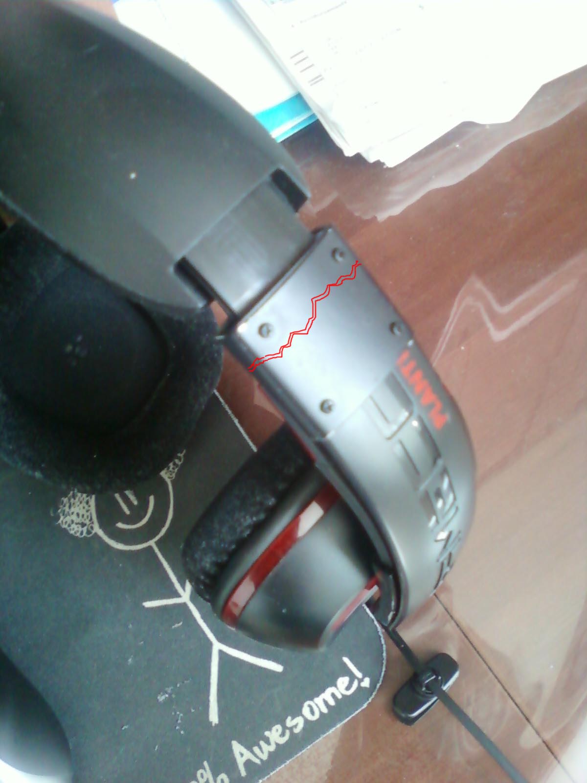

The end result was this:
The reason I don't have pictures of how I applied the steel strap to the headphones is because I did it a month ago, and it still feels as if I just put it together yesterday (My 3 brothers use the headphones daily, 1 after the other while I use my ATH-M50's lol).
`Edit*: The red lines display the location where the headphones had cracked a month before;
Anyways, It works like a charm and looks like a charm. What do you think?
