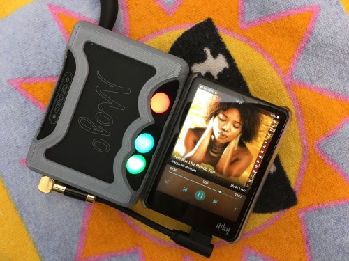

Your requirements make me think of the HiBy R6, but that's far out of budget at >500 USD
With the headphones you have I actually think they deserve a great source, which will cost more than $350...
The HiBy R3 also ticks the boxes for fluid UI and Tidal streaming, but I am not a huge fan of the SQ and the power output is on the low end, too low for some of your phones. I am pairing the R3 with the Chord Mojo, which would tick all the boxes, but together it is even more than the HiBy R6.
Maybe get a Mojo and pair it with a phone for streaming? You can find used Mojos for around 400.
Here's my HiBy R3 + Mojo combo. I am working on a 3D printed case for stacking them.
