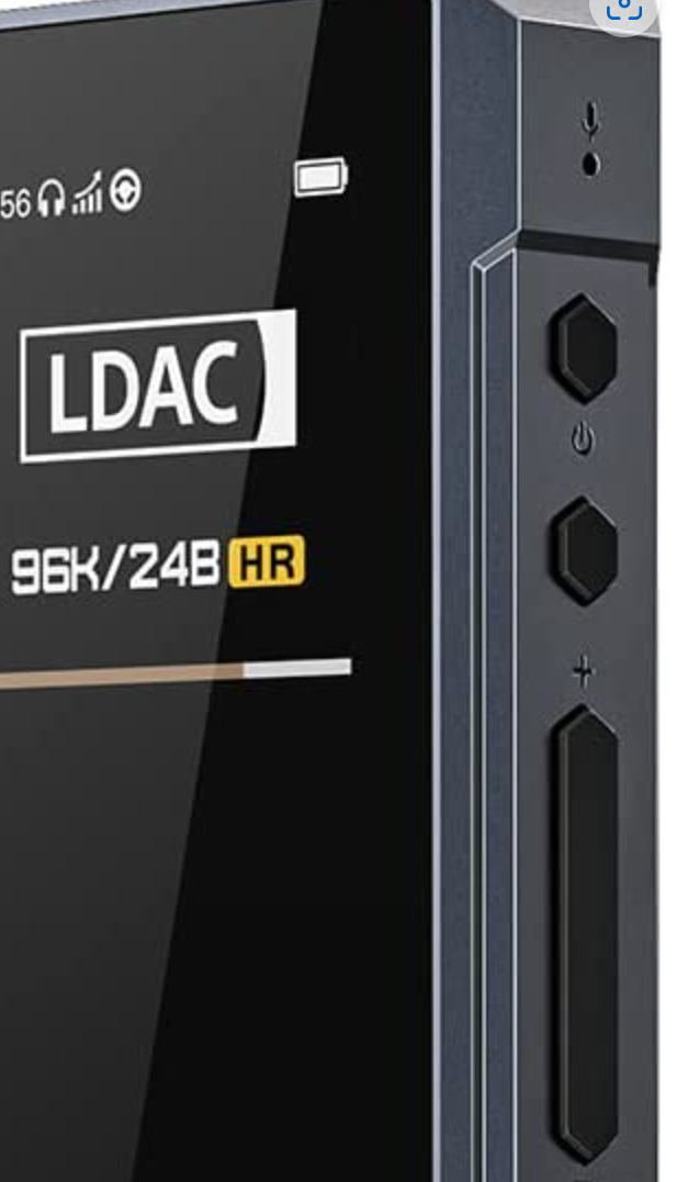

Hey guys,
My BTR7 makes a noise and reboots it's self when used in conjunction with BTA30 Pro. I assumed this was a defect and swapped it out today with a new one.
Unfortunately, same issue on the replacement. :anguished: Has anyone experienced this and know of a fix?
Chibs
Hi, even though I own the BTA30 Pro for a few months now, I very rarely use it because I am waiting to buy a desktop computer and permanently connect it. Today, I've connected it to one of my laptops and for the few hours I am now listening (LDAC), I have not observed anything unusual. I know it is very little time to test, though.
What I have observed is that skipping to next/previous track on the BTR7 does not work. Volume up/down and pausing the track, work. Next/previous track does not work.
I am listening to Amazon Music Unlimited using the App on my laptop. I am also using SounDevil (player) using local .WAV files. Next/previous works fine when connected to my phone, of course.
@FiiO , why is Next/Previous track not working, when BTR7 is connected to the BTA 30 Pro?
In any case, the sound is amazing and, more importantly for me, the combination BTA 30 Pro + BTR7 appears to have a bit more Bluetooth connectivity strength, compared to my BTR7 + my phone. This is important for me as I am using all these devices to listen to music in the best possible quality, while moving around the house doing various things.
PS: to be honest, my BTR7 stopped playing one time, in the few days I have it. I am always using it with my phone on me or in the same room. It just stopped playing. I rebooted and it worked again. This happened one time.
