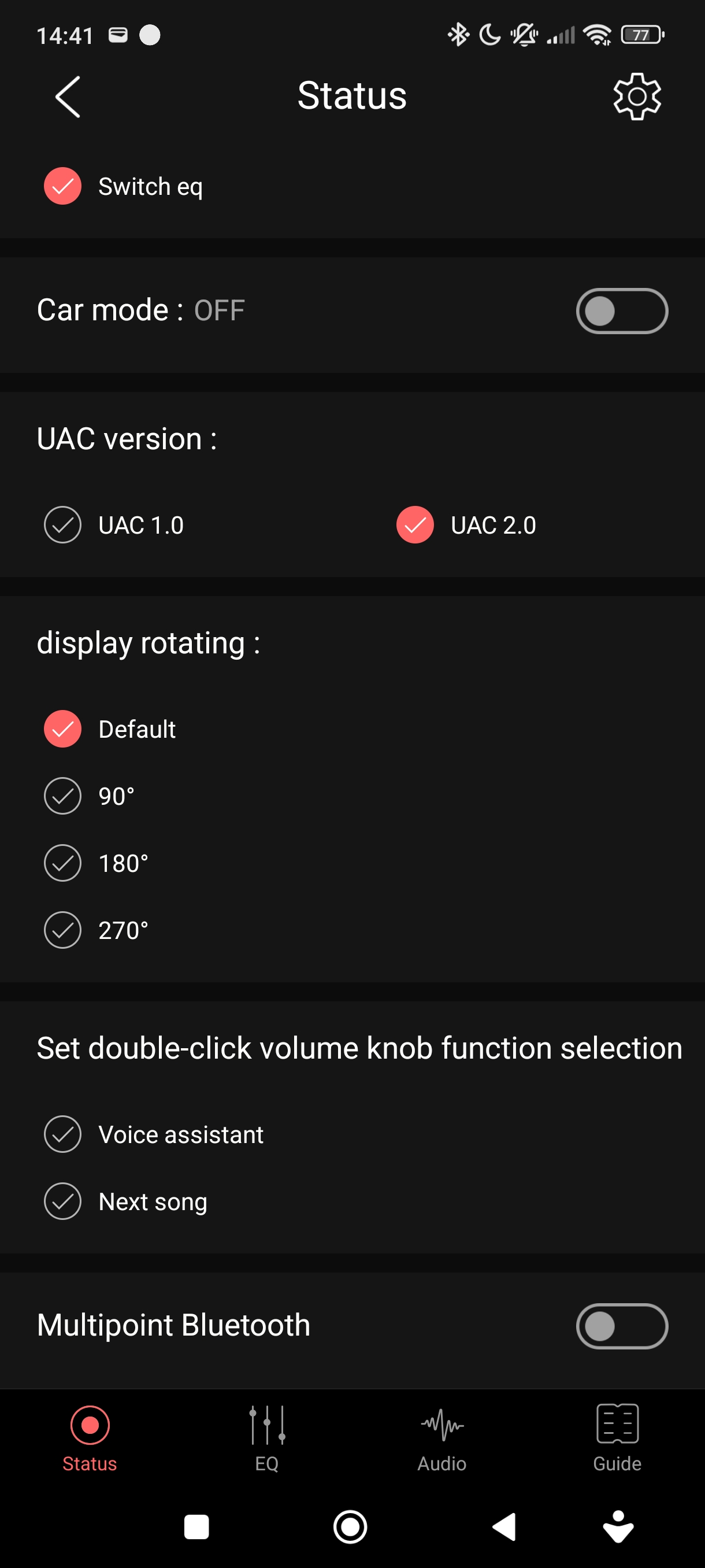

12. Will EQ take effect in USB DAC mode?
In UAC2.0 mode, EQ cannot be adjusted. While in Bluetooth and UAC1.0 mode, EQ can be adjusted.
