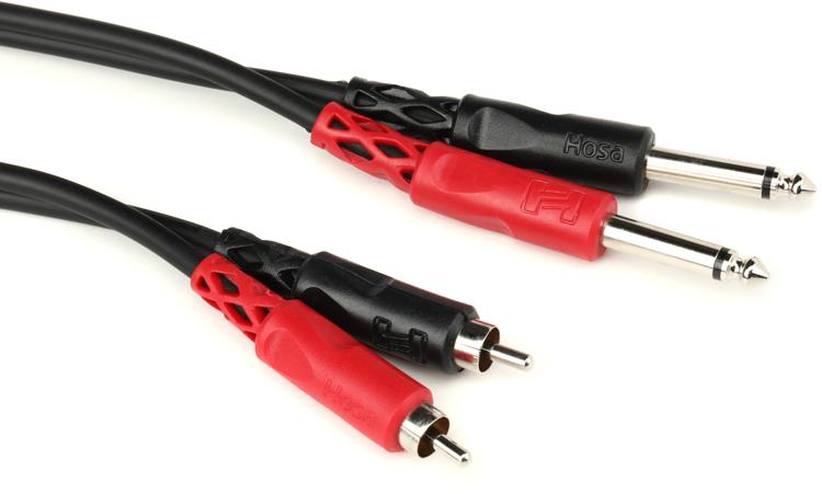

You would use the Main outputs of the 0202 to connect to your external amp. There are two options for this. One is to use the TS connectors, convert them to RCA using a TS->RCA converter cable
http://www.sweetwater.com/images/ite...R202-large.jpg
or use a converter with RCA cable cable.

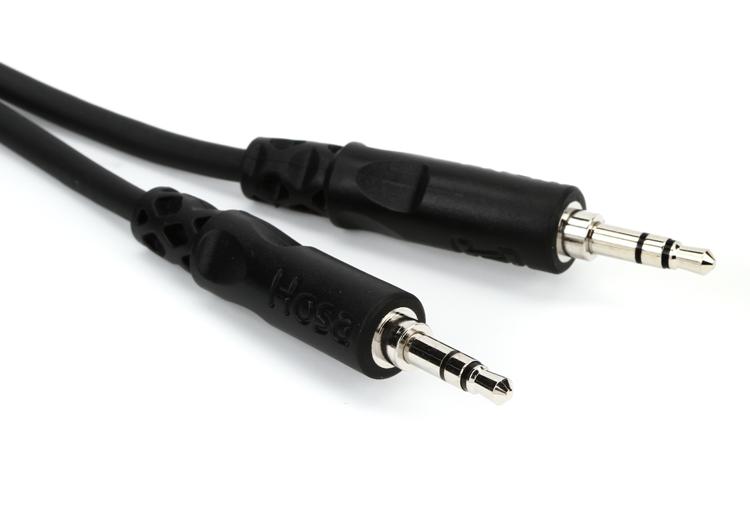

Or you can use a regular mini-mini
http://www.sweetwater.com/images/ite...M103-large.jpg
or mini-RCA connector since the 0202 has both.
