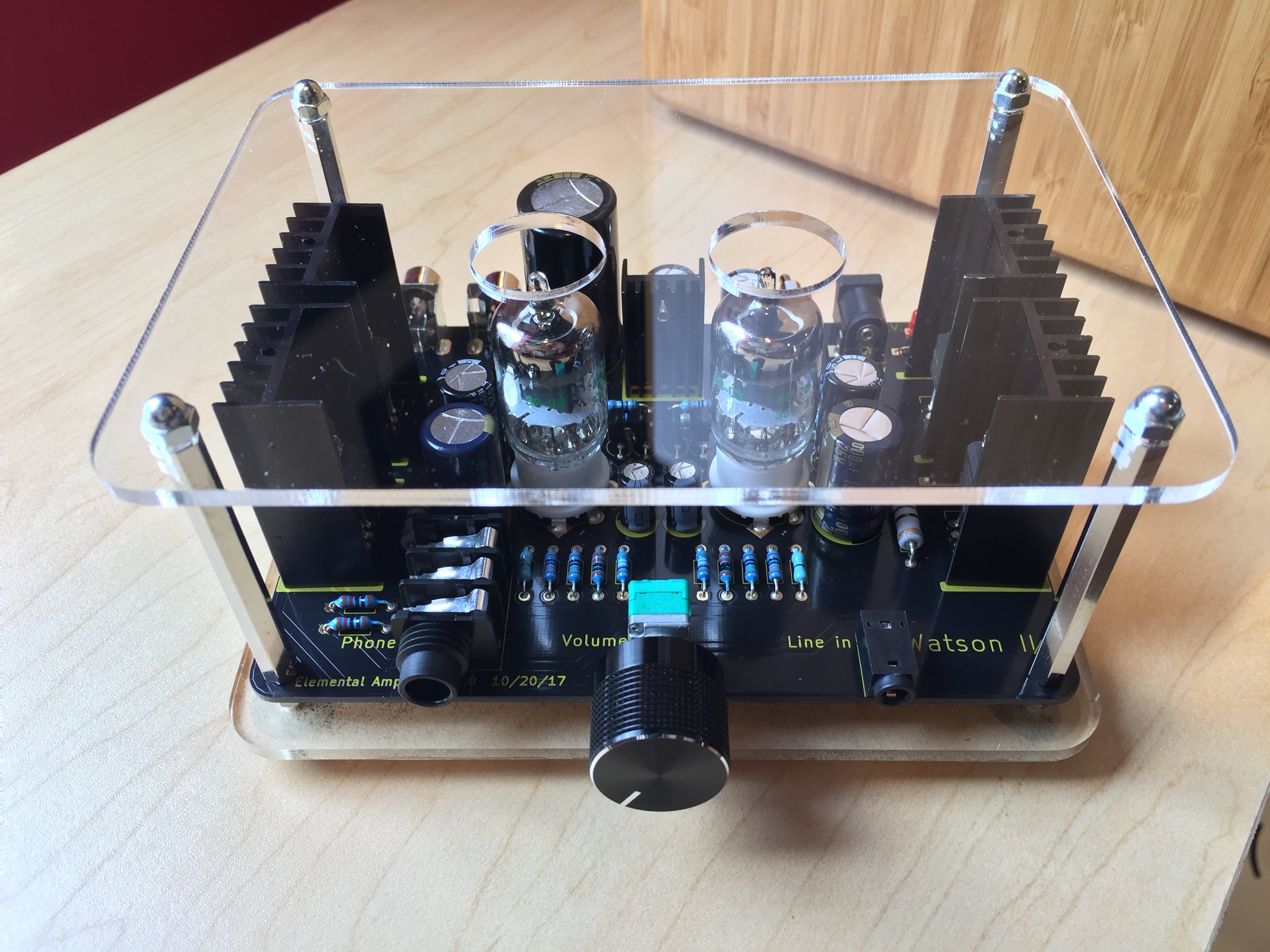

The valves are GE JAN 5654WE and are rollable, with other 5654/6AK5 equivalent valves.
The amp uses a dual-mono design, the valves are used on the gain stage, and the output is class-A mosfet powered.
It has a pair of RCA inputs, a 3.5mm line-input and a 6.3mm headphone output, this is an amp suited for hard to drive headphones, as the gain is high and there is channel imbalance at very low volumes.

Also one thing I hate about amps like this is LED's below the tubes to make it look like they glow, yes the tubes don't glow a lot on their own, but still I dislike LED's under valves.
So I replaced them with non light emiting Diodes, turns out you can't simply remove them from the circuit.
EDIT: LED's are probably the best choice to stick with, as they seem to serve a function in the circuit and their specs were probably chosen for a reason. So I have taken the diodes out and put the LED's back but on the underside of the board as the diodes were, and I painted them so the light doesn't show through.
