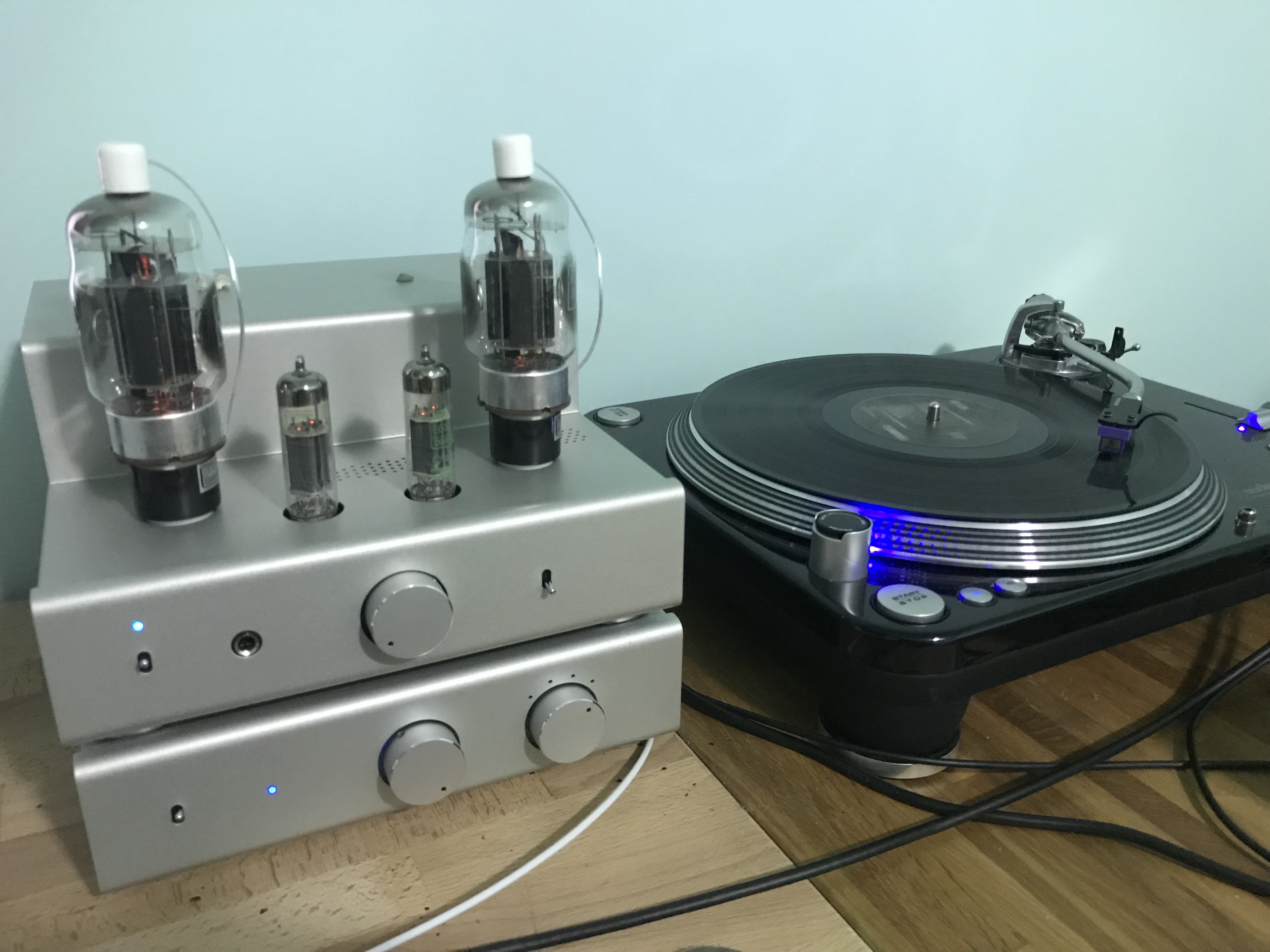

TU8200 is amazing. It is compact, it is versatile and it sounds really great! And also it is affordable. The base kit should cost more considering what's included and the quality. Yes, it stops being so affordable when all possible upgrades are applied to it. But it is one amazing amp, which is why I bought two kits for myself. It won't last forever, grab it while you can.
I spent some time with TU8340 with Lundahl transformers that Victor was kind enough to loan me to test it with my new big speakers. Then I hooked up TU8200 in parallel also known as "monoblock configuration" (notice- this is neither supported nor recommended by the manufacturer, so don't try this unless you are prepared to face the consequences on your own). And TU8200 with TT21 tubes sounded definitively better to my ears than TU8340 driving a large floor standing speaker. Yes, my TU8200 is probably the most upgraded unit out there (including larger power transformer), but still it fits in the same compact case. TU8340 is huge and heavy, a really well built amp and those Lundahls are great too. So for TU8200 to sound better while driving massive speaker it is amazing!
So yes, this is an amazing amp, that does not stop pleasuring my ears. And I built it myself, that gives me pleasure too! I listen to it every day when I get a chance, sometimes for 8+ hours per day. It is great. And so is TU8500 preamp including its phono section. Listening to this combo right now...
Oh and by the way, this thing will still be awesome long after the latest iPhone turns into obsolete garbage...
