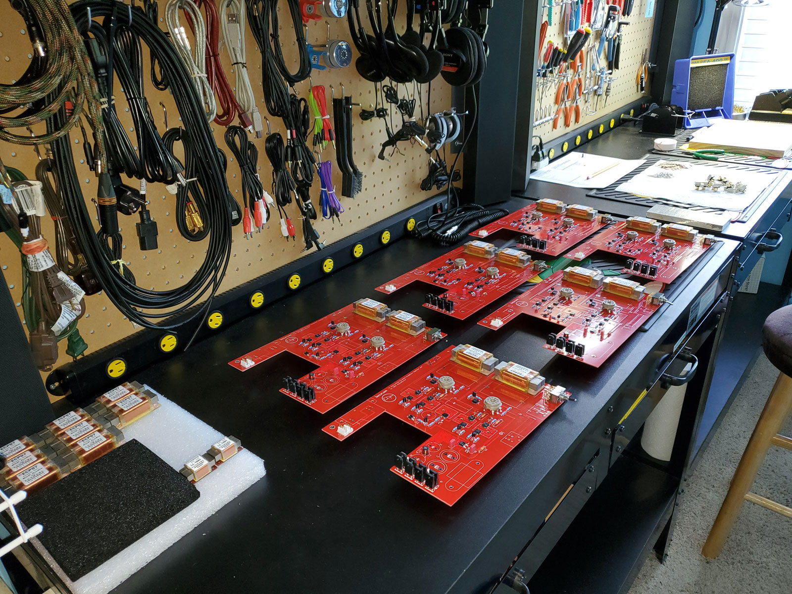

At this point, I'm able to stack the PCBs to save space while working on them:
As you can see, I've installed the Z-switch. At 4-pole, double-throw, it means 12 pins to solder for each switch. :scream:
Next up are the rectifiers, 4 for the tubes' B+ supply, and 4 for the tube heaters power supply. These are irritating to me. In a TO-220 form with only two leads each, they will shift not only backwards and forwards, but side-to-side as well. So, I solder one pin each with as best alignment as I can then flip over the PCB to check the alignment. Some creative bending is performed as necessary, then the PCB is flipped over and the remaining leads soldered:
I do four at a time, to ensure that I don't mix up the high-voltage rectifiers (tube B+) with the low-voltage ones (heaters). It helps that one set are completely rectangular, while the others have chamfered corners on top.

The wonderful Lundahl output transformers are next. As noted earlier from AtomicBob's extensive tests, the Lundahls result in the following output impedances for the T4:
HiZ: 26 ohms
LoZ: 6.3 ohms
I believe these are unheard-of values for a tube output-transformer amplifier, especially that one at LoZ, 6.3 ohms.
They have 20 pins each to solder! However, they're fairly low profile and flat. Plus, with that many pins, shifting is held to a minimum. Nevertheless, I solder two opposing ends pins first, on each transformer. Then I flip the PCB over to make certain they are straight and flush. Then flip the PCB back over again to solder the rest. I alternate soldering a pin on one transformer, then solder a pin on the other transformer. They're pretty tough, but the winding wire is awfully small and it's probably best to solder them this way so that not too much heat is built up. Alternating soldering from one OT to the other helps one cool while the other is heating up.
Mandatory use of the exhaust fan is needed, because the heat from the soldering iron definitely causes the lacquer to smoke. The lacquer around the windings stays untouched, thankfully, but I believe they probably immerse the entire transformer in the lacquer, which means it's on the pins and all around. So soldering the pins adds lacquer smoke to the solder flux smoke. It also causes the joints to dull. So, when you look at the bottom of a finished PCB, it may seem that the pins on the output transformers are cold joints - but they're not! That is the melted lacquer preventing the solder from having a shiny appearance.
Here are the output transformers installed, with a Lundahl-custom, ECP Audio part #:

Here are pics in a steady progression of installation to the six PCBs under construction. You'll note the stock of Lundahls at the left in the last pic:
The two tiniest Lundahls on the white foam are used as line-level outputs on the ECP Audio Walnut DAC.
Note that I can no longer stack the PCBs while working on them. The pins from the Lundahls on top will pierce the plastic wrap on the Lundahls underneath.

Things start going fairly fast, now. At least the parts are bigger, so it looks like more is being accomplished. Here you see the boards where I've installed the RCA jacks, heater power supply caps, and the Alps "Blue Velvet" RK27 volume pot. The RCA jack assembly is simple, with two plastic prongs that hook into holes on the PCB. They don't move after that. You only need to solder the signal and ground leads. The two electrolytic caps for the tube heater power supply are similar - just two leads, each. However, I take great care that they are soldered flush to the board. You would not believe how common it is with commercial electronics, including supposedly high-fidelity equipment, where electrolytic capacitors are soldered in all sorts of alignments, lead lengths, bent leads, etc. - everything but simply straight and flush to the PCB. I think a lot of high-fidelity equipment might all test about 10% better if greater care was taken with how electrolytic caps are soldered.
Anyway, with higher quality Panasonic FM capacitors such as these, it's actually the rubber plug that ends up being flush with the board. So, that's also a built-in vibration isolator. As with some of the other parts, I solder one lead each on the caps, flip the PCB over to check alignment, then solder the remaining lead.
I buy the Alps Blue Velvet stereo volume pots directly from Alps in Japan. The 50K version is best for headphone amplifiers, but it's not a standard stocked production model. So, any request for a 50K Alps must be a custom manufacturing run from the factory in Japan. I last purchased 400 of them from Alps soon after the horrible tsunami years ago. The Alps factory was hit by the tsunami, so they wanted 400 as a minimum order, instead of the previous 200 minimum. With that many pots, I still have a few dozen left today.:wink: Maybe in a sense, Beezar Audio contributed to Japan's reconstruction after the tsunami.
Anyway … the pots are difficult to solder, not because of anything having to do with the six pins, but because alignment is absolutely critical. They're also somewhat top-heavy. All of the pins are concentrated at the front and the weight of the shaft wants to make it topple off of the PCB. So, it's not so straightforward to get soldered in straight. Once you marry up the front plate and the giant machined-aluminum knob we use, it's too late to correct any tiny misalignment. I guess I should use a protractor mounted on the shaft or something like that, but there's no guarantee the PCB itself is aligned during soldering. So, I eyeball it - but very, very carefully. There is a scale square drawn on the PCB for the pot and it provides a great guide for alignment in the azimuth. However, alignment in the vertical is just as important. I solder the opposite back and front pins, then heat and cool the solder joints repeatedly while adjusting both the horizontal and vertical alignment. Once I'm happy it's flush and straight, then I solder the remaining pins. It takes a while for each pot, but is very important.
To the left, you can see the XLR jacks are next to be soldered. Here they are soldered in place:

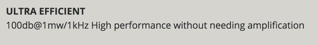

The Meze Empy is 31.6 ohm impedence and from their info page:
I Think the L4 has the size, simple beauty, XLR output and 12A** tubes that would be a good amp for me. (also a big Lindahl fan!) I want to be sure it would pair well with the Empy's and would like to hear from someone who has this combo before I but this amp! The other amp in the running is the ZMF Pendant.
Apr 25, 2020 at 12:20 PM Post #38 of 104
The Meze Empy info page:
Considering they are so efficient T4 should work fine with empy. Other planars might fare worse though, only efficient ones would be OK

Here is the choke installed:
PCB finished and complete:
And, once again - all 6 PCBs populated:
