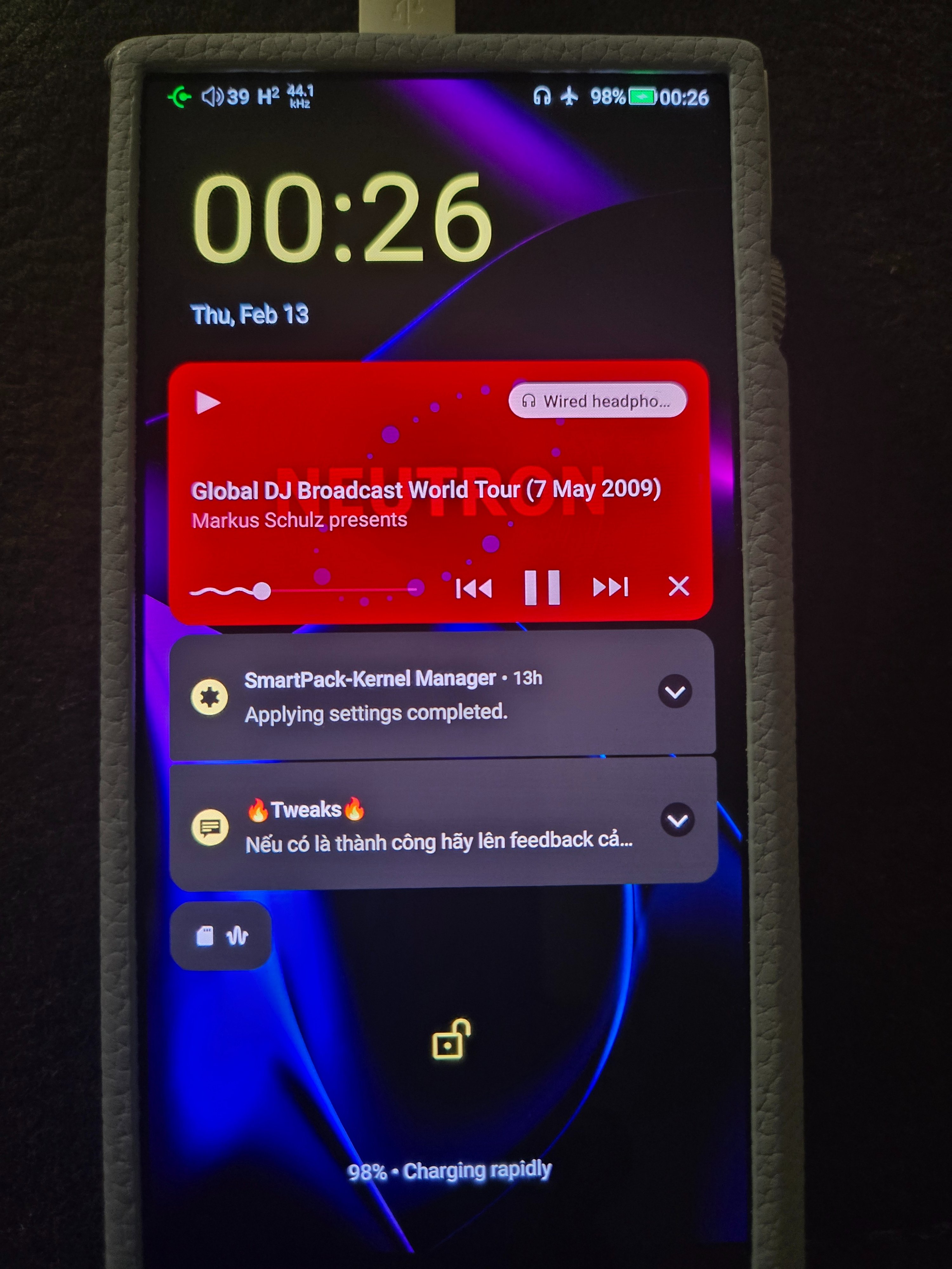

Glad it fixed that issue at least. I do NOT think you have a bad unit. I think there is some sort of bug. I have owned DX320,180 and 260. None of them had charging issues. I have pics of DAP says its charging but battery level drops! I was using a Anker charger that I used with all 3 other Ibasso's I have owned. You can see the crazy charging behavior. I do not know if I had 1.01 FW on there or not but I think I did. DAP was plugged in that entire time. Sure took ages to charge finally to 100%.

Glad it fixed that issue at least. I do NOT think you have a bad unit. I think there is some sort of bug. I have owned DX320,180 and 260. None of them had charging issues. I have pics of DAP says its charging but battery level drops! I was using a Anker charger that I used with all 3 other Ibasso's I have owned. You can see the crazy charging behavior. I do not know if I had 1.01 FW on there or not but I think I did. DAP was plugged in that entire time. Sure took ages to charge finally got
Something is defiantly up with the devices if your having some issues charging it kinda goes along with what I'm seeing. Hopefully more people are reading the posts and understand what im saying and can confirm. Hopefully bloom will have done there testing done by Thursday or Friday next week with the multitude of charging devices I sent them.
